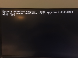

My intention is to pass it through to a VM as illustrated by the above XML snippet. I really have no idea how the raid works on this, I assume it's some custom bios as there are no jumpers on the board. Anyway my problem is when the VM boots up it just freezes on a page describing the SATA controller... (no OS installed yet, I have boot drive with the fedora 23 installation iso passed through as separate drive as well.... and when I don't pass through this SATA controller, it boots right into the live disk).
Here is what I see (attached), and I tried pushing all F keys and Del key... nothing.
