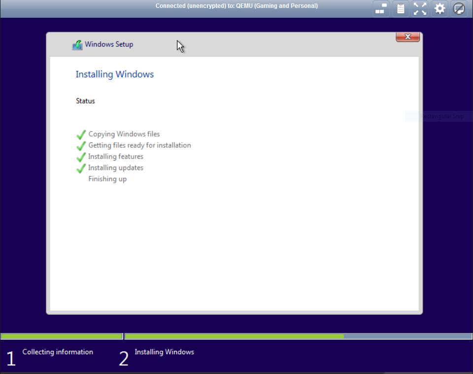

I am trying to install Windows 10 Pro as a VM in 6.2.0-beta21.
The installer can be started and proceeds until it is switching from "Installing updates" to "Finishing up"; screenshot attached.
The failed state is:
  • VNC Session to VM continues working fine; cannot do anything, but the mouse moves around
  • Web interface stops responding altogether
  • SSH logon still works, running top shoes a high CPU usage for "wa", waiting for I/O
  • top also shows CPU usage matching "wa" usage for qemu-system-x86
  • top also shows "load average" above 15.0, all indicating lots of I/O load
  • even running "reboot" from CLI will not break the lock; the system must be power cycled
I have tried leaving the system running for many hours, the state does not change.

I am still experiencing this issue. It still requires physically powercycling the machine.
FYI, in general you can shutdown VMs from the command line with:
virsh list
virsh shutdown <numberOfVM>
virsh destroy <numberOfVM>
Of course, didn't work in this case:
error: Timed out during operation: cannot acquire state change lock (held by remoteDispatchDomainGetBlockInfo)
I upgraded my installation to 6.2 rc2 after getting the VMs installed using 6.1.9.
I think the same essential issue cropped up again, in that the Windows VMs began performing very badly, and when I went to investigate I found qemu-system-x86 process chewing up all of the cpu cores assigned to those VMs.
I was unable to shut one of them down and powered-off the whole machine. When I went to restart my motherboard decided to die on me for the second time, so I have not been able to resume diagnosis.
So, I was able to temporarily bypass the issue by using 6.1.9 to install Windows VMs, but a similar issue appears to have emerged after I installed 6.2. For this reason I think that this is a Unraid 6.2 issue with Windows in general, not only with installation.
I haven't been looking for other reports since my Mobo died for the obvious reason that I can't do anything about it until the RMA process is complete.
Any updates on this? I'm experiencing the same while installing Windows 7. The last step freezes and in UnRaid the VM pauses and I can't unpause it "internal error: unable to execute QEMU command 'cont'...". The Win 10 Installation was flawless though, since I'm running this right now. Wouldn't want to downgrade since im using NVMe.
not sure if it will help, but many other issues around installing/upgrading Windows have been resolved by limiting the VM to a single vCPU while installing, and only enabling more vCPUs when the install completes.
Interesting suggestion to use a single vCPU.
I do not have any update. I regularly reboot my two Windows VMs to avoid the lockups. I find that sometimes the whole machine begins performing poorly, and that I can save the hard powercycle by rebooting the Windows VMs manually before it locks up.
I have not tried again to install Windows on 6.2; still using installations created on 6.1.9.
Thank you very much! Using one CPU (cpu0) worked fine. Although after restarting it and adding the other cores it didn't boot up anymore (stuck at win symbol). Tried some more combinations and I
'm back to all the cores I wanted to use and it works. Don't know what's different but it works.
You may be onto something here.  I have been trying to install Windows 7 the last 24 hours but finding it was just hanging at the Windows logo.  Downgraded to V6.1.9 from RC2 and bang.  Installer came straight up.

For windows 7 do not use the QXL VNC video, use the Cirrus.
https://lime-technology.com/forum/index.php?topic=52359.0
Can confirm there is no issue with creating a Windows 7 VM in unRAID 6.2 that I can find.  I was able to install Windows 7 just fine right now on a test machine.  No errors.  Chances are you have corrupt installation media or something amiss with your hardware.  If the VM enters a paused state, it could also be because of insufficient disk space on the underlying storage device.
Hey, that's good to know, so it's something on my machine. I solved it by only using 1 cpu. Right now I think it was either that or that I'm not using the emulatorpin option anymore. Something cpu related though I think.
Jonp- it might be worth adding a note to the VM documentation to use the above mentioned Cirrus VNC instead of QXL.  I could not get Windows 7 installed using QXL
