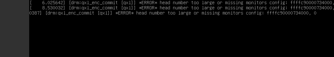

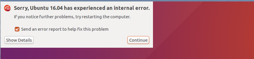

I can succesfully boot and start installation (default install - no LVM), however after the first reboot (after it's installed it asks me to reboot), I sometimes can get to the loginscreen, but never past it. I just see some flickering and an error in the background which keeps closing and popping up.
Sometimes i get errors when booting. I attached some screenshots.

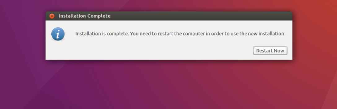

Attached screenshots after succesfull installation and after reboot.

I get the errors you can see in the attached screenshots.
