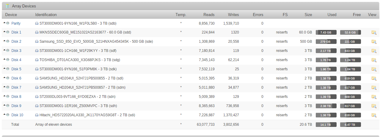

That seesaw effect is usually caused by reiserfs, change your disks to xfs, if you want you can use a xfs disk on your cache slot to confirm 1st.

This seesaw effect only happens on v6 with reiserfs and copys to server, reads from server and writes to reiserfs v5 server are normal.

They indeed all are.  They predate my upgrade to v6 (except 1 i think).

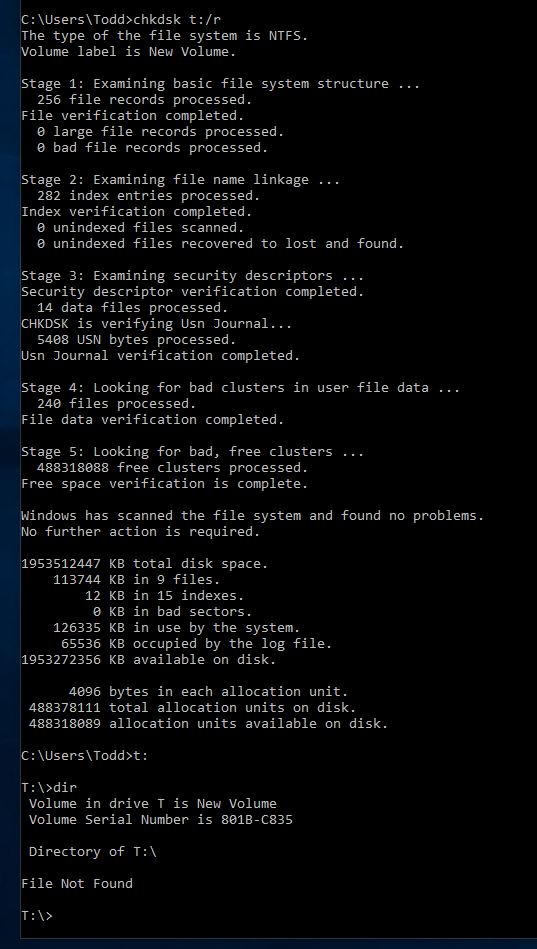

OK so this seems odd.  I found an old 2 TB drive that I havne't used in about a year.  put it in an external enclosure connected eSata and after formatting ran chkdsk /r just to make sure there were no bad sectors.  It was previously running in my unRaid rig and was really just wanting some verification since it sat on a shelf.
See the attached results.  the summary says there were 9 files in 15 indexes on a freshly formatted drive, directory shows nothing.  Is that part of the NTFS format structure?
Wild guess at this point would be that these files are hidden system files.  Have you googled about this issue?  And why do you care as you formatted the drive and you knew this would cobber everything on the drive?
They are, don't worry about them. https://support.microsoft.com/en-us/kb/103657
