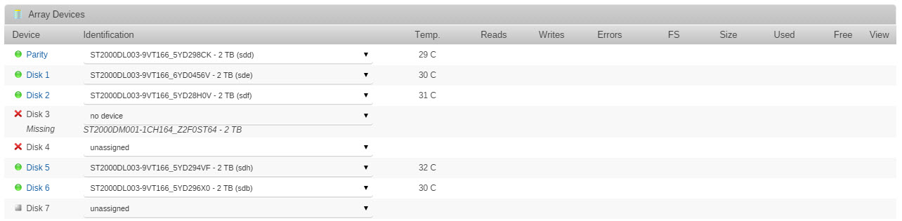

Post a screenshot of Main showing your Array Devices.
Here you go.
sdc - do you know if this was the serial of Drive 4?
Serial Number:    5YD28DZQ

You might be able to trick the system into rebuilding disk3. Not clear if it would work since it is not clear what state parity is likely to be in with 2 drives out. It may not really be in sync with disk4 since that was the first one out and it may have been writing parity while emulating disk4. Once disk3 went out parity wouldn't have been used anymore. Also, SMART for parity is perhaps the worst of the drives. If you want to try it anyway you could:
New Config - Assign a new drive to disk3. Assign all other drives exactly as before. Check the box saying parity is already valid, then start the array.
Stop the array, unassign disk3, start the array. This will make it think disk3 is missing and needs to be rebuilt.
Stop the array, reassign disk3, start the array and let it rebuild disk3.
