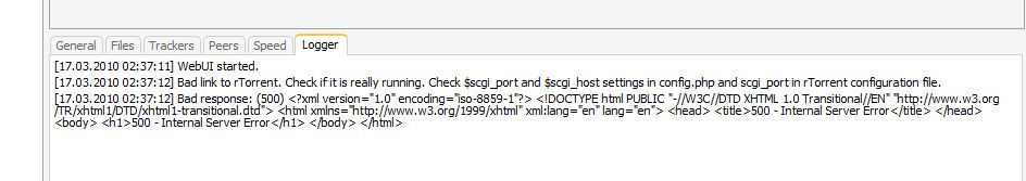

window opens in firefox but I have an error in the bottom of the window
[19.12.2009 11:39:36] WebUI started.
[19.12.2009 11:39:36] Bad link to rTorrent. Check if it is really running. Check $scgi_port and $scgi_host
settings in config.php and scgi_port in rTorrent configuration file.
[19.12.2009 11:39:37] Bad response: (500) <?xml version="1.0" encoding="iso-8859-1"?> <!DOCTYPE html PUBLIC
"-//W3C//DTD XHTML 1.0 Transitional//EN" "http://www.w3.org/TR/xhtml1/DTD/xhtml1-transitional.dtd"> <html
xmlns="http://www.w3.org/1999/xhtml" xml:lang="en" lang="en"> <head> <title>500 - Internal Server
Error</title> </head> <body> <h1>500 - Internal Server Error</h1> </body> </html>
i browsed thru the whole topic and didnt see a response to this question...
im having this similar problem, but after some searching in the forums i found that if i manually delete the .rtorrent.rc file and do the installpkg command, the file gets recreated and everything works again. but if i reboot the server and go script runs the installpkg command, i get this error again.
still very new to unraid and linux especially, so bare with me pls.

I had that kind of error and I solve it adding some lines to my go script  :
#install unRUtorrent
installpkg /(...)/unRUtorrent/unto*
#sleep 10
untorrent stop
sleep 10
untorrent start

This means that you are installing the package before your array is fully started.
You can just add 'sleep 20' before the installpkg command.

well before i even try that i can see that it would not really work, because of the /unrutorrent directory, which i do not have even if i create it what do i put in there?? the installpkg ntorrent-2.8.5.full-i486-1pur.tgz??? the pkg currently resides in /packages with all other stuff from unmenu
To create a directory you type:
mkdir -p /path/to/directory
The -p option will create intermediate directories if needed.

i still have this same issue, i added some lines to the go script, but still everytime it boots, i get that error and rtorrent is useless until i manually delete the .rc file and reinstall the pkg.
what am i doing wrong???
#!/bin/bash
# Start the Management Utility
/usr/local/sbin/emhttp &
echo nameserver 192.168.1.1 >/etc/resolv.conf
echo 192.168.0.102 unraid >>/etc/hosts
sleep 30
for i in /dev/md*
do
    blockdev --setra 2048 $i
done
echo "/boot/unmenu/uu" | at now + 1 minute
cd /boot/packages && find . -name '*.auto_install' -type f -print | sort | xargs -n1 sh -c
sleep 30
installpkg /boot/packages/untorrent-2.8.5.full-i486-1pur.tgz
PATH=$PATH:/boot/custom/bin
cache_dirs -w -e "Backup" -d 3
