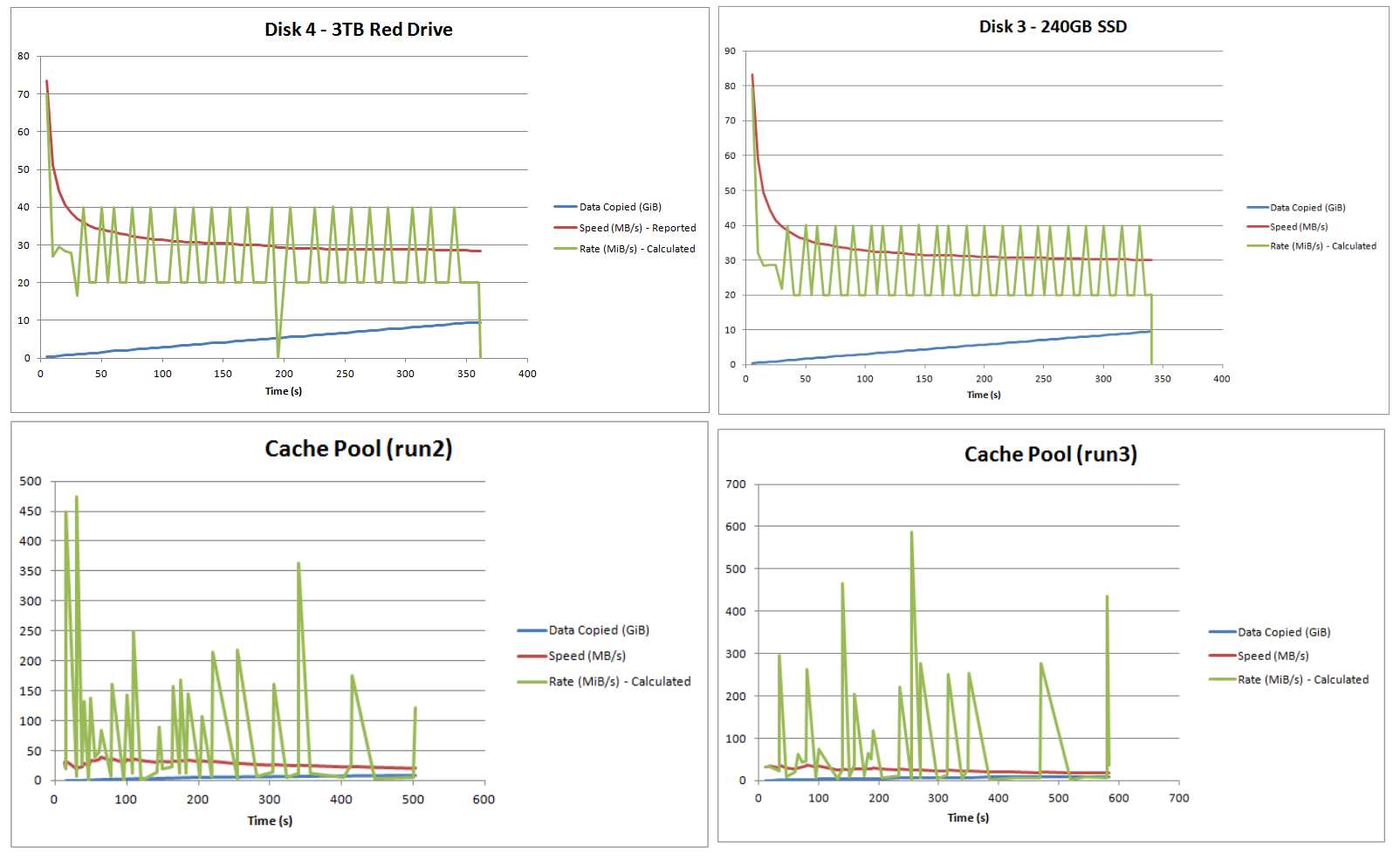

Write to /mnt/cache took 13.5 mins (12.6MB/s) with multiple periods where either slowdowns or hanging of data writing occured - e.g. stuck at 9.0GB written for >60s.
Write to /mnt/disk4 took 6 minutes (28.3MB/s) - constant speed
Write to /mnt/disk 3 took 5m 40s (30.1MB/s) - constant speed
So definitely a problem somewhere with the cache pool. How do I now start to work out the cause of the problem?

EDIT: I ran another few runs using write_speed_test.sh and copied the output from the terminal into excel and plotted the write speeds (both the speed reported by dd as well as a value I calculated manually from the terminal data) over time. I have attached these as an image and it's pretty telling and confirms a problem in the cache pool.
