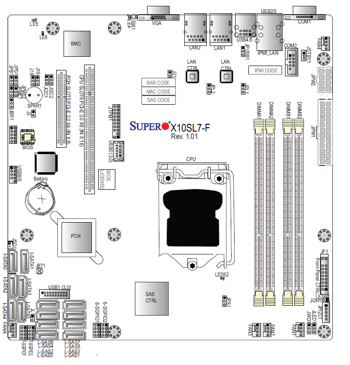

3. my mother board
I have attached the manual in case that is helpful

Ok, thanks I will check into Jonp's post again.  I looked at it earlier but I didn't quite understand it.  With my new found knowledge it may make more sense now.
What is strange though is when I plug in my spare USB drive to what the motherboard shows as USB0 and USB1 it still shows up in lsusb as USB3.  Could this be because I am using a USB 2.0 drive and because it is reverse compatible it is assigning it to a different BUS?
I believe so. My usb3 pci card does the same. All usb2 devices show up on one bus, all usb3 on the other, regardless of which physical port is used
