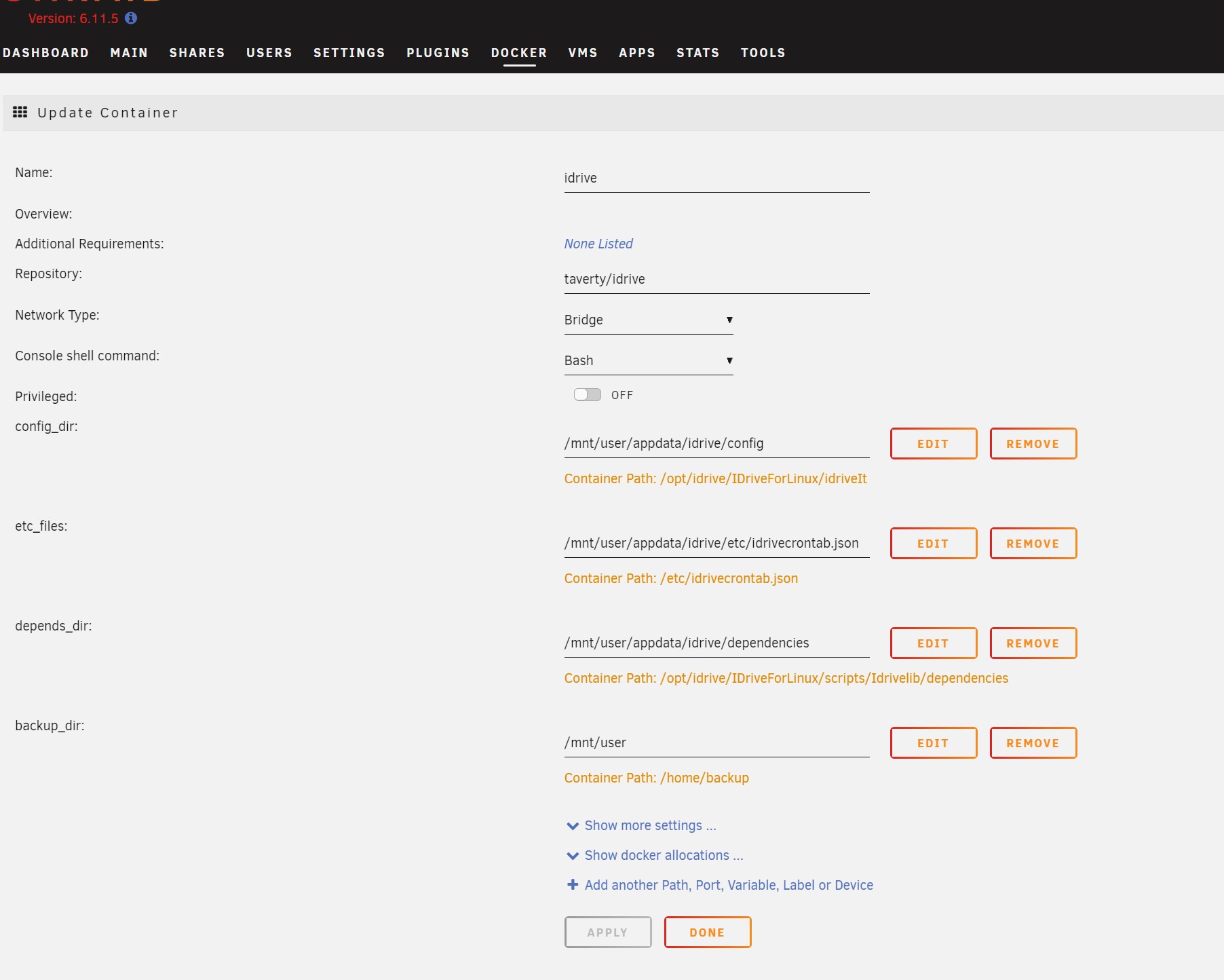

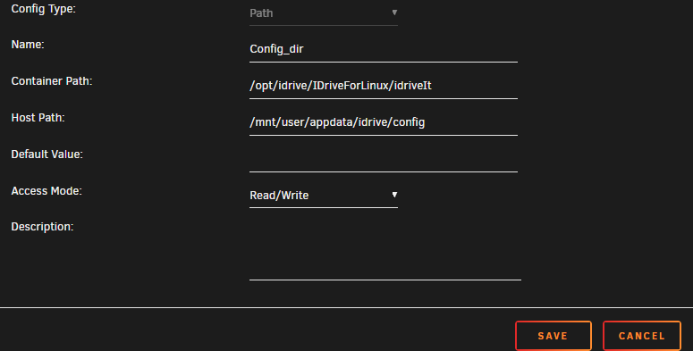

You'll need to setup your persistent mappings in unRAID like the docker-compose example.  I attached a screenshot showing my setup.  Be sure to create an empty idrivecrontab.json file on you local system before starting the container. Use the touch command, (touch /mnt/user/appdata/idrive/etc/idrivecrontab.json) in a terminal.
All mappings are Read/Write with the exception of the backup_dir, that's set to Read Only.
all mappings are Read/Write with the exception of the backup_dir, that's set to Read Only.
 Install idrive docker on unraid under APPS Tab:
This is a summary of Taverty walking me through setting up IDrive, I hope it can help someone else!! If anything needs to be added let me know!!
https://hub.docker.com/r/taverty/idrive/
1- Search for idrive under APPS tab
2- Click on link labeled:  Click Here To Get More Results From DockerHub
3- Choose taverty/idrive
4- Let unraid download and convert to use with unraid

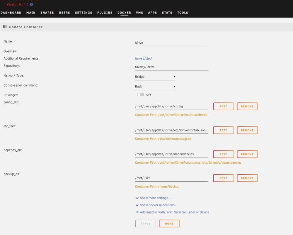

5- Update docker container and create required paths below: See pic's for example
Config_dir
container path
/opt/idrive/IDriveForLinux/idriveIt
host path
/mnt/user/appdata/idrive/config
etc_files
container path
host path
depends_dir
container path
/opt/idrive/IDriveForLinux/scripts/Idrivelib/dependencies
host path
/mnt/user/appdata/idrive/dependencies
backup_dir
container path
/home/backup
host path
/mnt/user
under the Advanced View add link for icon
https://static.idriveonlinebackup.com/source/images/favicon.ico
Apply Changes

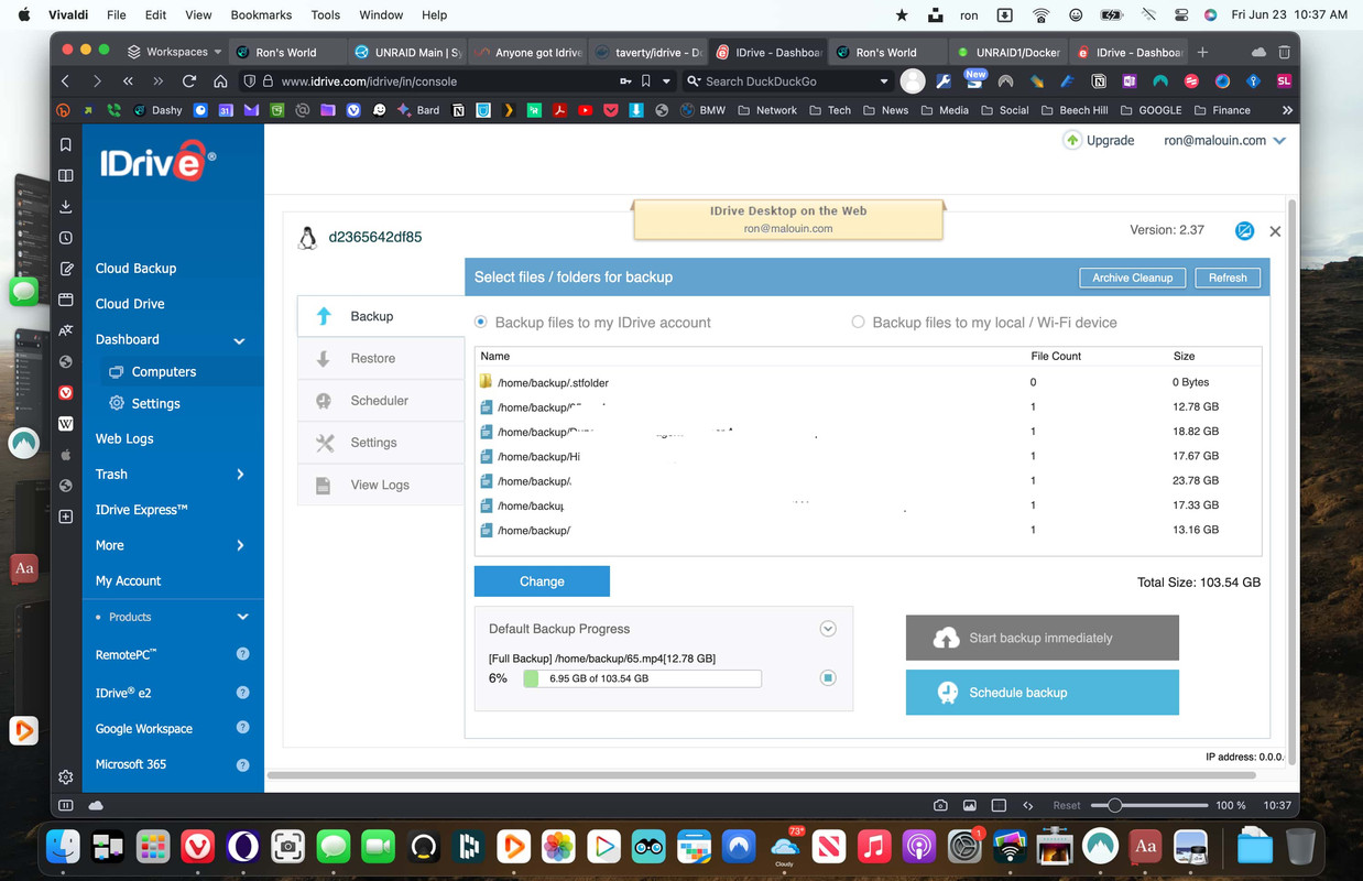

sign into idrive online and check dashboard then computers
Done

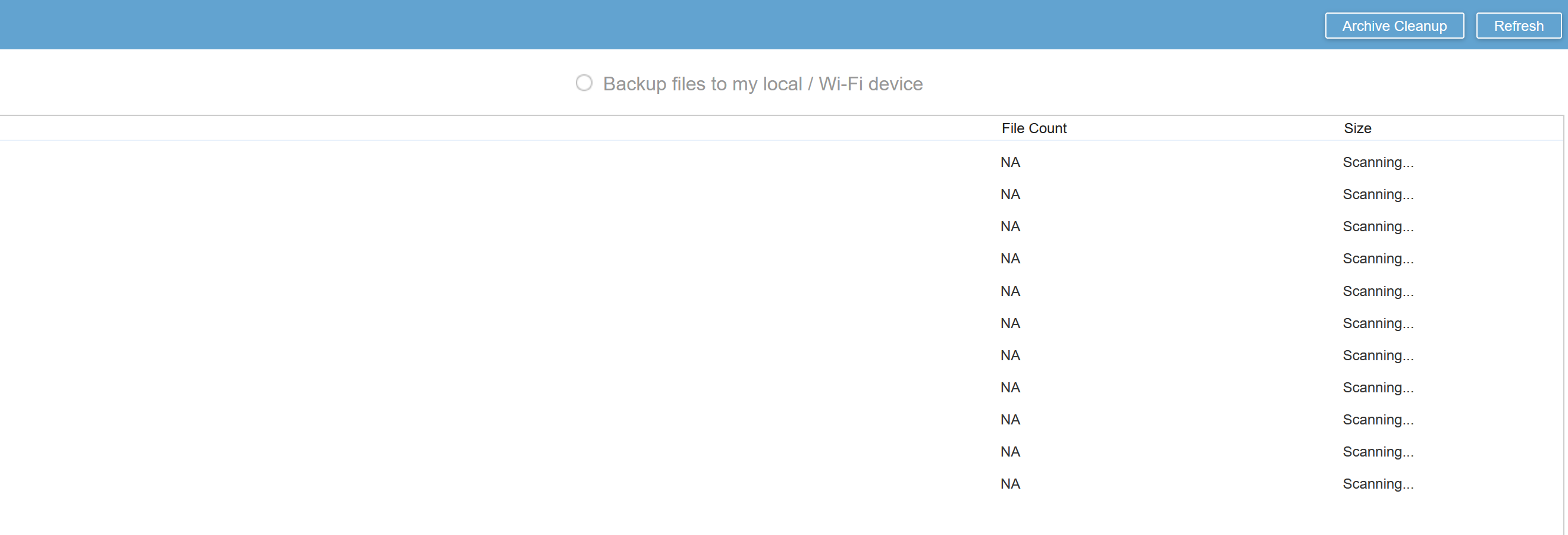

Hi All,
Thanks for these clear steps. The issue I'm experiencing is that after following the steps the initial backup works fine, CDP also works for like a day. Then that's it. Perhaps I'm not the only one.
In the dashboard the server appears as online, also when I try to add a folder for backup that connection appears to work as well (new folders are visible).
status_retrieval.pl results in:
Preparing File list...
Latest backup job status: cancelled (which I did not do). Also when checking the schedule there is a warning: Last backupset scan did not complete: Backup.

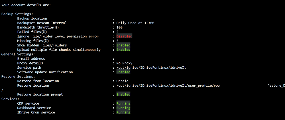

Account settings (attached).
I tried re-installing, updating etc but so far only 1 backup for each try :).
File count appears to be stuck at NA (attached).
Kind regards
Koen

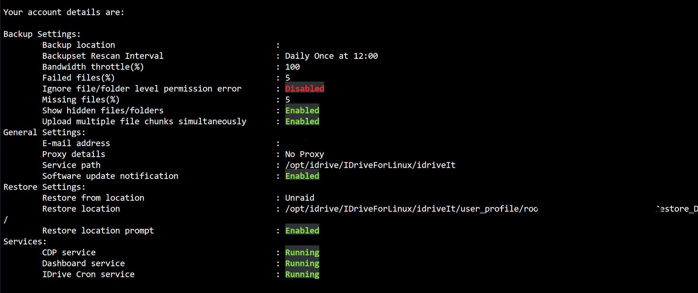

Your desktop access has been "Enabled".
Your 'Upload multiple file chunks simultaneously' option has been "Enabled".
Default missing files percentage to notify as 'Failure' is set to 5%.
If the total files missing for backup is more than 5%, then backup will be notified as failure.
Your default backupset scan interval is set to 'Daily Once' at 12:00.
Your default bandwidth throttle is set to 100%.
Your default Backupset file has been created successfully.
Your default Restoreset file has been created successfully.
Your default Local Backupset file has been created successfully.
Your default Local Restoreset file has been created successfully.
Your default Full Exclude list file has been created successfully.
Your default Partial Exclude list file has been created successfully.
Your default Regex Exclude list file has been created successfully.
"<email>" is configured successfully. Do you want to login as "<email>" (y/n)?
Enter your choice: y
"<email>" is logged in successfully.
...the end of setup...
root@xxxxxxxx:/opt/idrive/IDriveForLinux/scripts#
Confirm iDrive local Docker container "daemon" (app) is running:
root@xxxxxxxx:/opt/idrive/IDriveForLinux/scripts# ps --no-headers -o comm 1
entrypoint.sh
Good, now read "readme.txt" (e.g. `more readme.txt`)
1. edit backup option from cmdline (if comfortable with 'vi')
   ./edit_supported_files.pl
   - option 1, add "/home/backup" to folder and ZZ to Save & Quit vi
2. Run your first backup
   ./Backup_Script.pl
3. Go check in iDrive Web console () what's happening
  https://www.idrive.com/idrive/in/console?path=/remote/devices
That's it!
Edited by LoneStar
There is a little bit of work to do in iDrive to get this working correctly. See attached for what you need to do in iDrive. share.jpg

Thanks, everyone, for the great info on setting this up. It appears to be working, but not without a couple of issues.
I backed up a small folder and it said files backed up successfully, but on the iDrive website, under UnRaid, there are no files.
Trying to connect to UnRaid is very slow and unreliable. If it connects, it disconnects before I can change any settings.
On 8/1/2023 at 10:52 AM, Ectropian said:
Does anyone know how to turn off CDP in the container?  Since I only want the backup set to run at a specific time, when I untick the checkbox on the website it does not push down to the container.  When I run ./account_setting.pl it shows the CDP server is running.  running ./cdp_server.pl (stop) does not stop the service (does nothing).  In Scheduler you can only set CDP schedule realtime, or in minutes.  Think I've tried everything I can think of. Anyone else have any ideas?
When I do get the remote connection to work, it shows CDP is unchecked. But, it is running in the container. I don't see a way to stop it, only options are start and restart. I think, maybe it runs all the time, it just doesn't do anything if it's not checked.

On 3/16/2023 at 7:47 PM, taverty said:
It has been a while.  But from what I remember I just exec'd into the container and ran the ./account_setting.pl script.  Pretty sure it asked for my password during that script run.  To Exec into the container run the following command at the unRAID command prompt:
docker exec -it idrive /bin/bash
The above command will bring you to a bash prompt inside the idrive docker container.
Once at that prompt, run the following command:
The directory in the idrive container should be: /opt/idrive/IDriveForLinux/scripts
Once you're in the container you can run all the iDrive scripts as if you were running them on a standard Linux installation.
