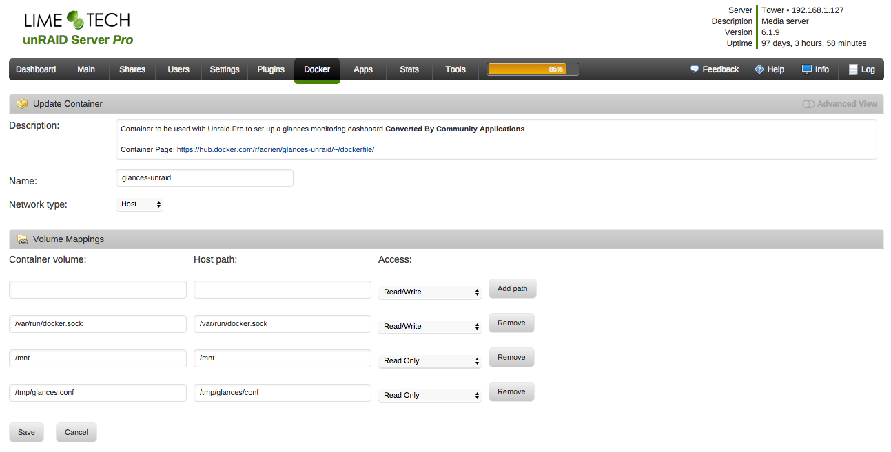

June 18, 201610 yr Note that the webUI line listed a couple posts up is the incorrect way of entering it. Host port irrelevant since its host mode. No config mapping required only /var/run/docker.sock 6.2: 6.1.x:
