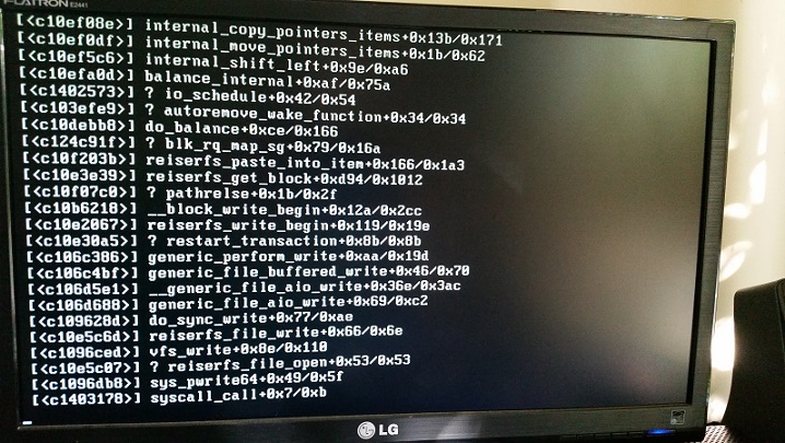

Took a photo of what the screen shows when connected to the server. Hope that gives some more ideas.
Thanks
Since reiserfs is mentioned in the crash screen, I'd do a file system check on all your drives.

So I ran the file system check across my drives, and 1 came back with this.
Comparing bitmaps..Bad nodes were found, Semantic pass skipped
10 found corruptions can be fixed only when running with --rebuild-tree
So looked at doing the rebuild but I read it has its risks. What are your thoughts?
And can someone explain why this may only cause crashes when the array is running but be perfectly stable stopped or in maintenance mode?
Cheers
SDG_Disk4_Error.txt
Yes, you have a badly corrupted file system on that disk, with multiple corruptions dictating the need for the --rebuild-tree option.  I assume you've been reading Check Disk File systems?  Go ahead and proceed with that option, but be aware there's a good chance there's some data loss, and even what it recovers may require some handwork, to restore the right file name and put in the right folder.
It's rare but there have been other occasions when certain forms of corruption in the Reiser file system could actually crash the system.  The crashes could only happen of course when you were actually using the corrupt file system on that drive.
