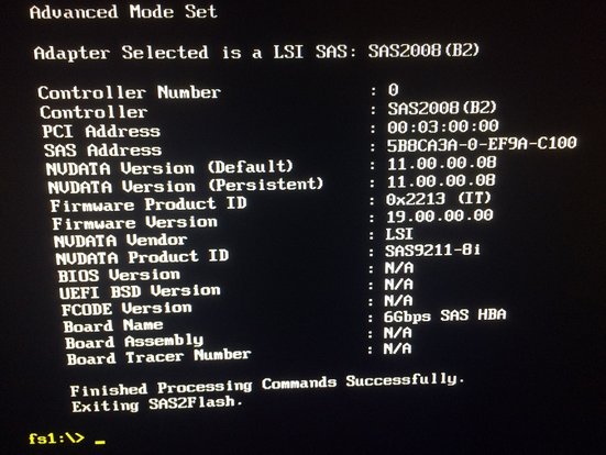

Ok Ill try and explain this as best as I can.
I have a IBM ServeRAID M1015 card which has been crossflashed and running sweet.
I picked up a Dell H310 and flashed that to IT mode. Flashing was successful.... well I think it was in anycase.(First Pic)

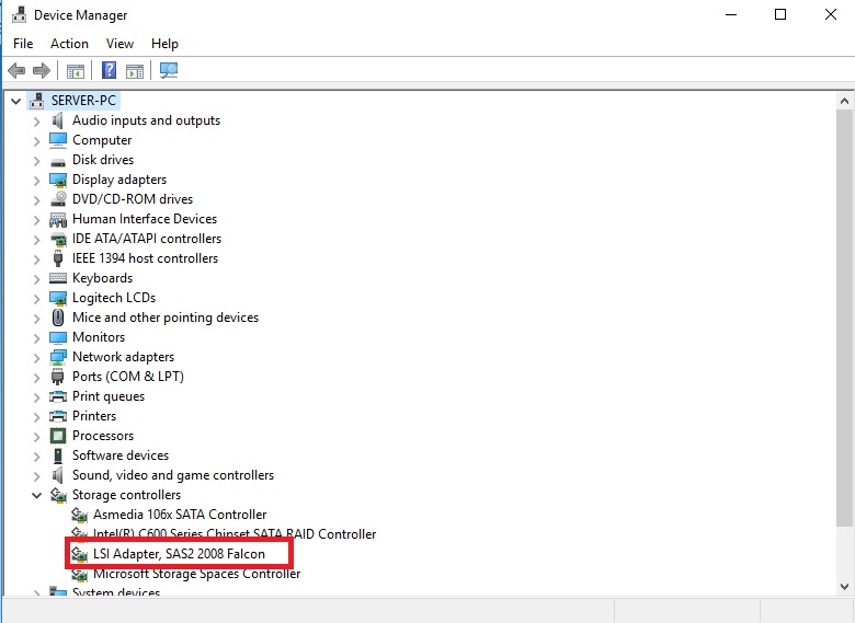

So off I go to my daily driver pc..... plug the H310 in and from what I can see.... I have green flashing light and when in Windows it shows up in device manager. (Second Pic)
Am I missing something here?
Probably a board incompatibility, you can look for a bios update but doubt it will work.
