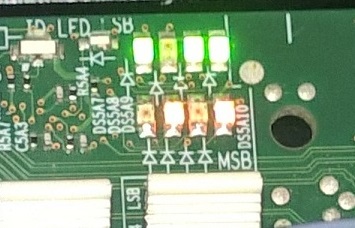

May 28, 201610 yr I have installed cpu 1 (waiting for additional 8 pin power cable before I can install cpu 2) along with 4 ECC dimms in the four blue colour coded dimms slots. Can anybody with this board help diagnose the diagnostics? I'm a little lost looking through the diagnostics in this book. I tried checking out the interactive diagnostics here for the S2600CP motherboard and E5-2600 v2 processor but the number on the board does not appear to line up with the interactive codes. Is 3 the left mode green led on the board? Manual: http://www.mouser.com/ds/2/612/g26942005_s2600cp_p4000cp_tps_r1_8-275549.pdf Interactive Diagnostic Checker: http://www.intel.com/content/www/us/en/support/boards-and-kits/000007059.html?wapkw=034129#
May 28, 201610 yr Author Found the BIOS Default jumper and followed the procedure in the manual for resetting the bios. I can now get the display to come on and can get into the bios. It's detecting cpu 1 (which is currently the only one installed) and the 32 gigs of ram installed on cpu 1. Progress!!
