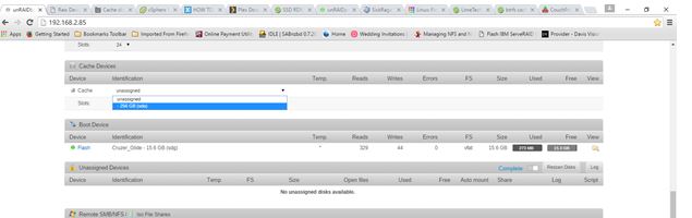

  Then I thought about making that cache disk a VMware data store disk instead and pass a traditional vmdk disk as my caching disk just to see if it can be done.  There was alot of wasted space on the disk the way I was using it that made this option attractive.  I rsynced my RDM cache disk into the raid array and removed it. When assigning a typical vmdk, it failed to show up by disk-id and when assigning a device as a cache disk, unraid GUI just showed sda and the disk size with no other identifying characteristics.  Assigning the cache disk wouldn't stick and the web page constantly showed the cache drive as unassigned after just assigning the disk.
  Hmmmm not desirable I say, so I back it all out.  Removed the SSD drive from vmware's storage pool and setup a RDM disk again and the same thing happened again and it was just working before....  I manually formatted, mounted and restored my cache disk data which got my dockers up however unRAID does not see it as a cache disk via the GUI.

After doing this, unRAID picked up my manually populated disk ID's and I was able to assign the cache drive.
