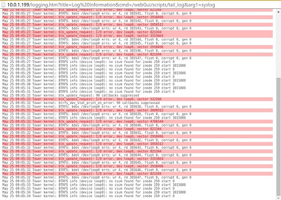

I'll start off by saying that I'm relatively new to unRAID so apologies if I seem relatively unfamiliar with the system.
I installed Docker, and got my plex app, deluge app, and couch potato + sonarr installed.
I finally got everything configured and now, at random time intervals, several containers will just stop running and refuse to restart.
I got as much log information as I could, not really knowing which steps to start taking to correct the issue.

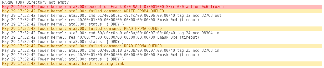

I've tried reseating a the SSD cache sata cable thinking that might be the issue but no luck there.
Some insight would be very much appreciated.
Thanks everyone.
(sorry for the small log images, size limitation was hard to workaround)

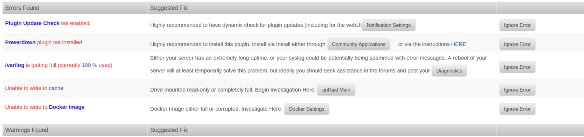

Run this plugin and see what it flags up because something is jacked.
Here's what's been found.
I think the read only file system is what's causing issues.
the SSD has 70GB free so it's definitely not full.
Your syslog filesystem is full.
Your docker imagefile is full.
Well, I just installed it a few days ago.
Is there a way to expand the filesystem?
Assuming the docker image is mounted on the cache drive then it's not necessarily full because the cache drive is either full or corrupted and in read only mode.  That problem has to be fixed first before anything else.  (but after a reboot to clear out the log)
