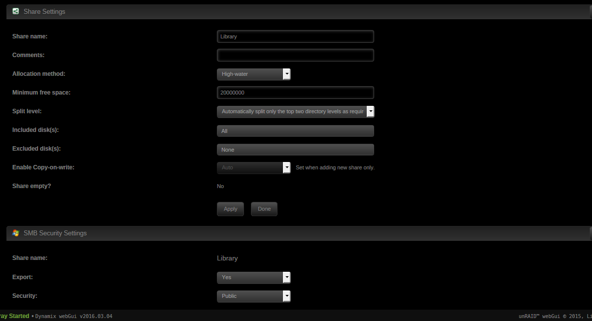

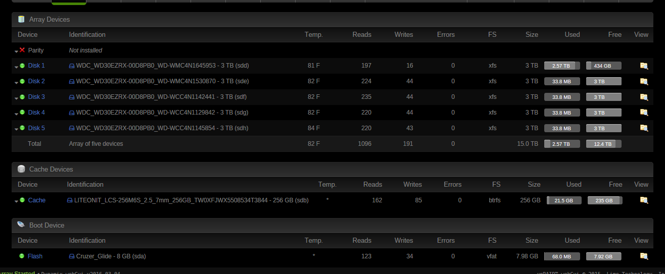

Hello folks, I'm new to unraid and really excited to start using it ;D. I'm coming from Ubuntu Server 14. I've got a good idea on how highwater works but it's not working for my shares. It just fills the drive up. Here is my Directory setup. Currently my Library share is set to Level 2. Would anybody have any idea on why its not doing 50/50/50/50/50 then back to drive 1? Also my parity drive is not installed yet as all of my data resides on that disk that Im migrating from.

Bump. I've went through everything, Its still filling the drive up.

if you want everything split evenly without restricting what folder gets placed on what drive, you need to set it to be "Automatically split any directory as required"
right now, the way you have the share setup is that the top level (share) and the folder under it need to be on the same drive. Since you created the folder before moving any data, the system wants to keep everything on disk 1.

Ive did this and its still putting everything on the same drive.
