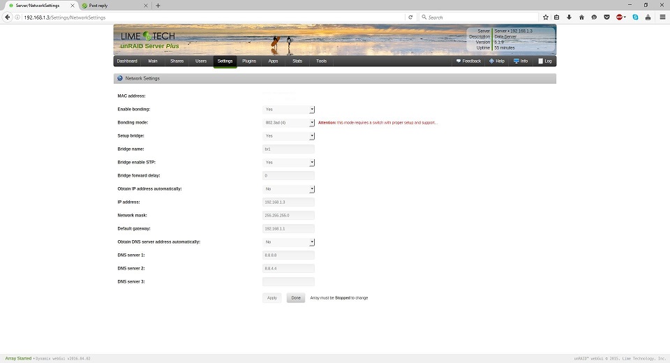

Today I added another NIC to my N40L https://www.amazon.co.uk/gp/product/B001CY0P7G enabled bonding same as my other machine that already has a dual nic.
Problem is when I have both ethernet cables plugged in I lose all connection, as soon as I take 1 cable out doesnt matter which one it starts to work again.

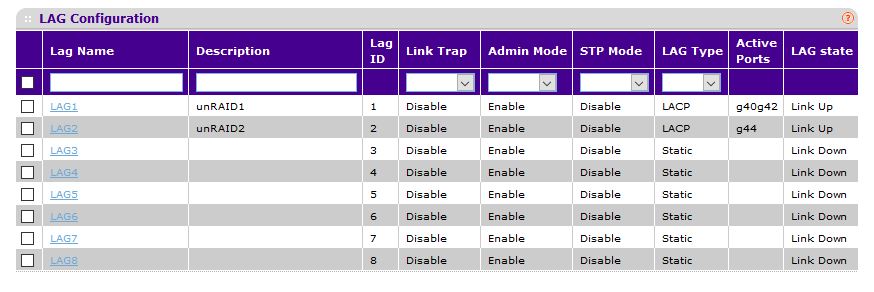

I set it up with static ip and LAG is setup on my swtich. LAG1 for ports 40 and 42. LAG2 for ports 44 and 46.
Also changed bridge name to br1 and br0 is setup on my other machine. What am I doing wrong?
Does this look right? Before it was set to static by default, switched it to LCAP.
However cable 46 is now disconnected and im not at that location to test.
Will have to give it another go tomorrow. Thanks for looking over settings :)

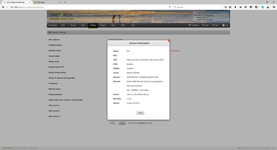

Question... both machines now using 2nic bonding but how do I actually test it?
Network: bond0: IEEE 802.3ad Dynamic link aggregation
eth0: 1000Mb/s - Full Duplex
eth1: 1000Mb/s - Full Duplex
My desktop is still on 1GbE. Both machines have SSD drives so simply copy and paste job shows around 110MB/s but that was the case before bonding the nics.

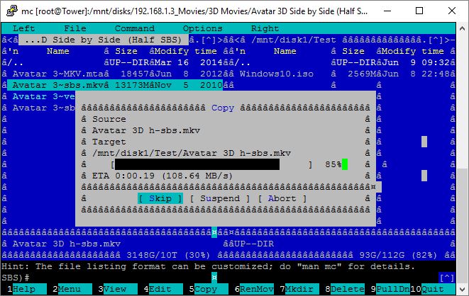

Using putty and MC to get rid of the windows copy and paste I get around the same speeds. So is Dynamic link aggregation the correct method I should be using?
Using LACP you can only get more than Gigabit speed during multiple transfers, i.e., if you transfer a file to one server from your desktop and another from the other unRAID server at the same time both should get gigabit speed.

Ok that make sense, so if for example I have a couple of plex streams and decide to transfer some data I will pretty much wont see loss in speed.
I guess this is a more sensible setup but what if I want to have 2gb transfer speeds between the unraid systems? Thinking about it it might be nice to just see it working but the way it setup now is fine too as I have atleast 4 family members who regulary use my plex server.

So as long as still getting 110MB/s whilst other stuff is going on like plex streams, kodi playback and downloading using sab, it should be setup and working correctly.
