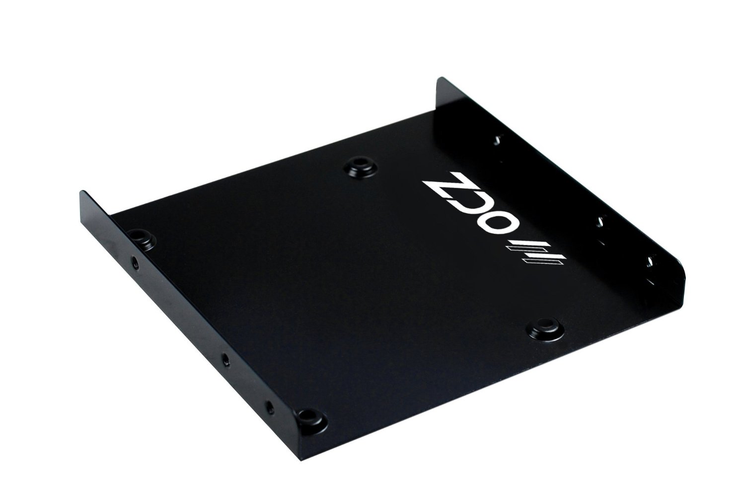

Not familiar with your case in particular but this is the method I used to mount an SSD securely without taking up a precious HDD slot. I used a 3.5" SSD adapter (see pic for example), mounted SSD to adapter and then mounted the adapter vertically against the back of the case using case screws through the adapter and into 2 of the "air holes" on the back surface of the case.
