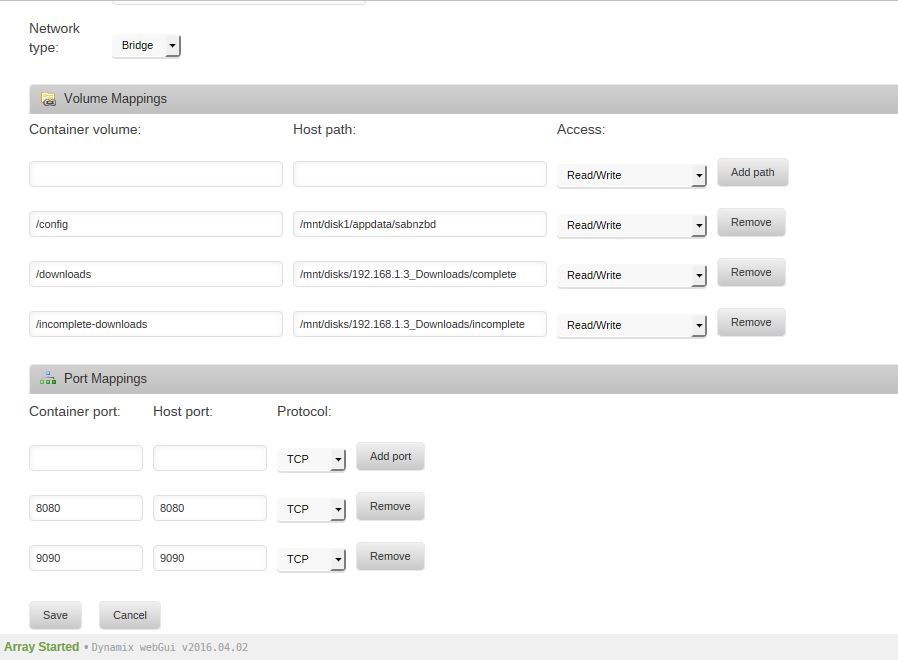

Other issue is how do I automate downloads on TOWER using CP SAB etc but instead of directly being saved to a share on tower which only has 120gb have them download directly to /mnt/disks/192.168.1.3_Downloads and is this the best method or should I let it download locally then figure out somehow to move it later?

For the sab thing use unassigned devices in your download server to mount your movies share on your storage server.  Then use appropriate host and container mappings on sab and tell it to move those files.  It'll get transferred directly to the other server.
If you're using 6.2 make sure the mapping is rw slave mode.  Of on 6.1.9 you've got to stop and restart the entire docker service to get it to recognize the ud moubt

I dont think I have this the wrong way round, but on machine 1 created share called downloads
Machine where sab is installed using unassigned devices mounted the share from machine 1 and put it in mappings and restarted docker.
Still no joy it just want to download to local machine not my data machine.
Stop of restart the docker service not just the container.  And make sure that you have sab set up correctly to use that path

Appears to be working got confused because of the folder names, so I just called the folders test and test-incomplete and it showed up fine.
Downloads are slightly slower over network to other machine but some tweaking might fix that.
