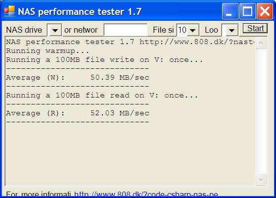

I have attached the output of a cute program called NASTester which records the read and write performance of a network.
My U drive is in a ubuntu server and V drive is the Unraid server, both are wired connections to the same netwrk that my windows machine is wired to. It is a Netgear D6200 gigabit router and they all have gigabit NI on motherboard.
As you can see the read/write on the ubuntu server is fine and the write to Unraid is fine but the read rate is 0.6MB/s.

I disabled the onboard NIC and used a PCI NIC.
Instant return to usable read speeds.
See attached NAStester jpg.
I can't say if the fault was a coincindence with the install of 6.1.9 or related.
