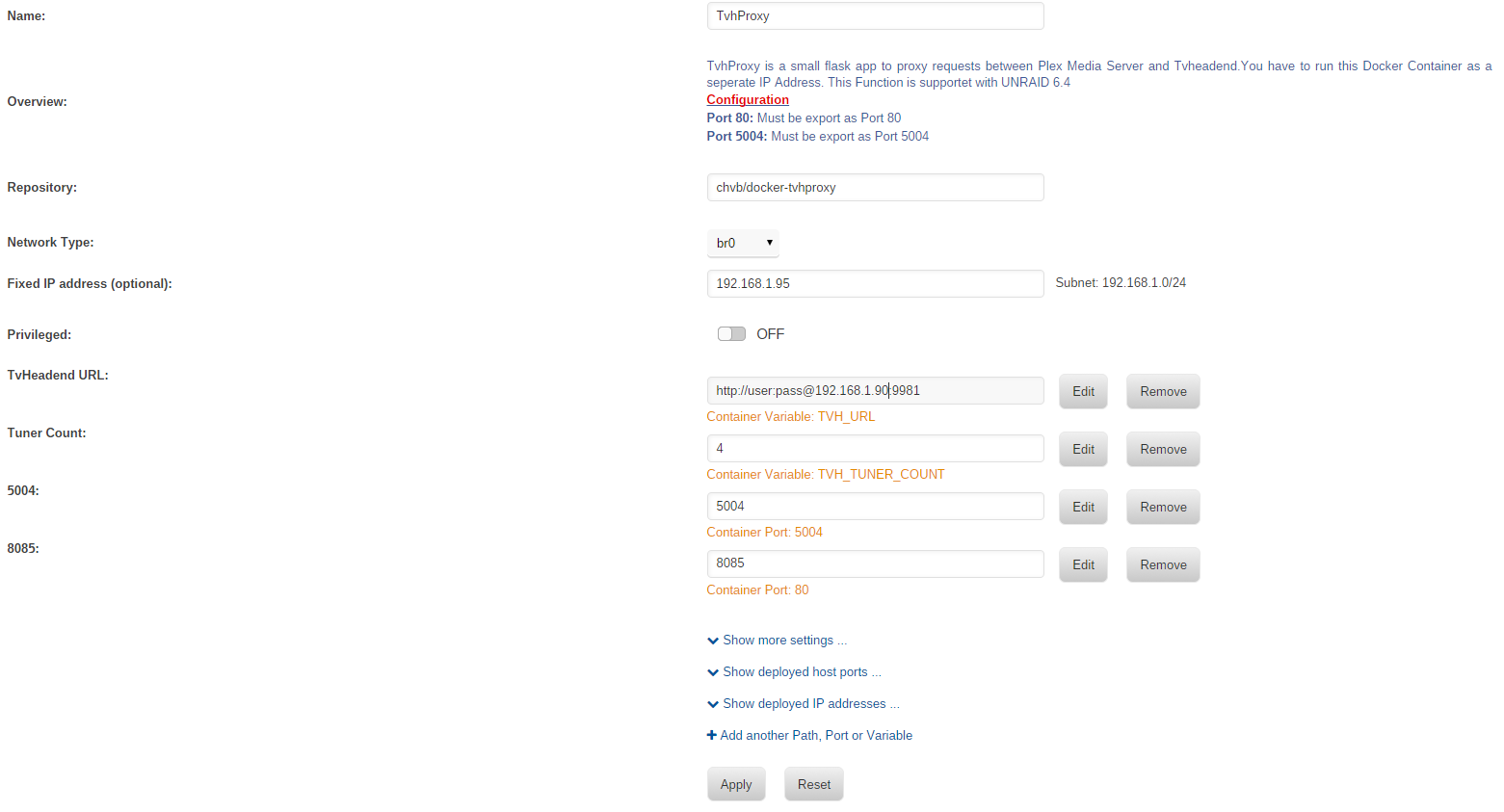

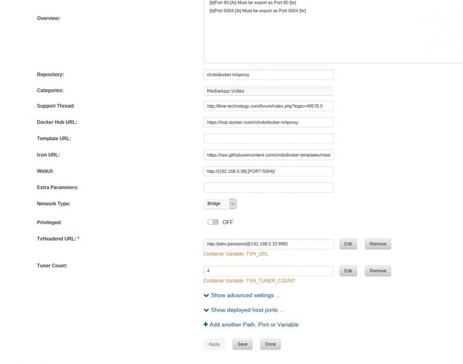

I've got Plex & TVHeadend installed (the latter needs reconfiguring after I cleared it out to start again, but it does work), and I'm looking to get TVHProxy up and running.  Giving all different IPs isn't ideal, but it's not the end of the world.
Do I have to add the two Container Ports manually, and I may be being stupid, but I don't have the option of a br0 network type.  Any idea?
Can anyone see anything wrong with this setup please as I cannot get tvhproxy to start?
File "/opt/tvhproxy/tvhProxy.py", line 81, in <module>
http.serve_forever()

Now I've got TVH running as I want it, I'm moving on to TVHProxy.
Are you guys running the 6.4 version of Unraid to enable dockers on different IPs?
Exactly, remember, all dockers on sep ip's ...

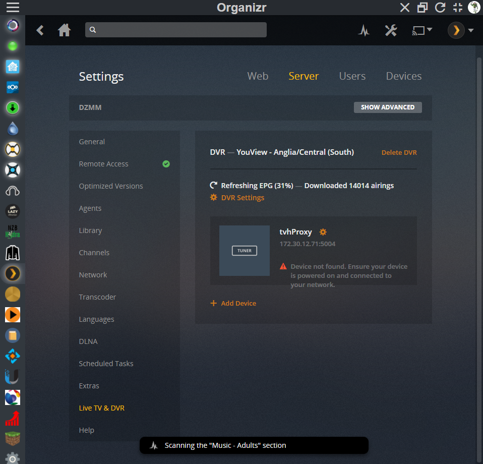

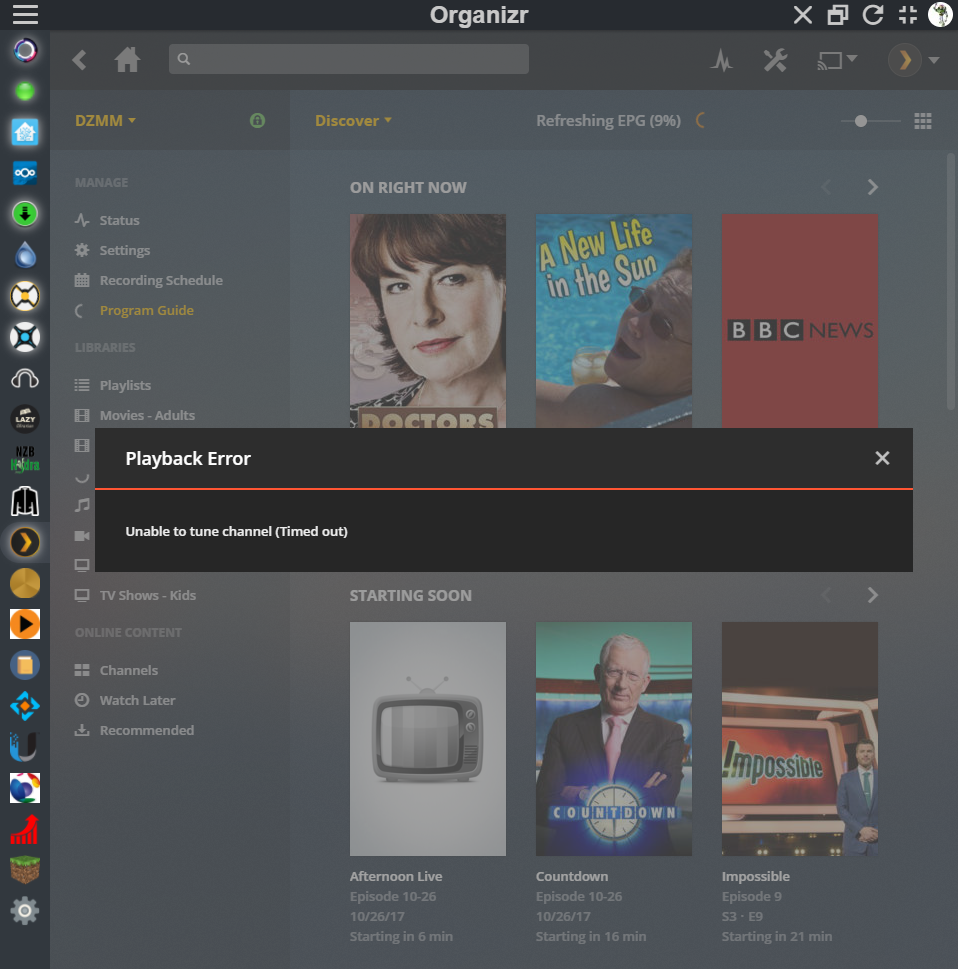

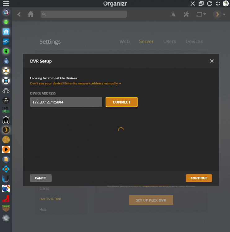

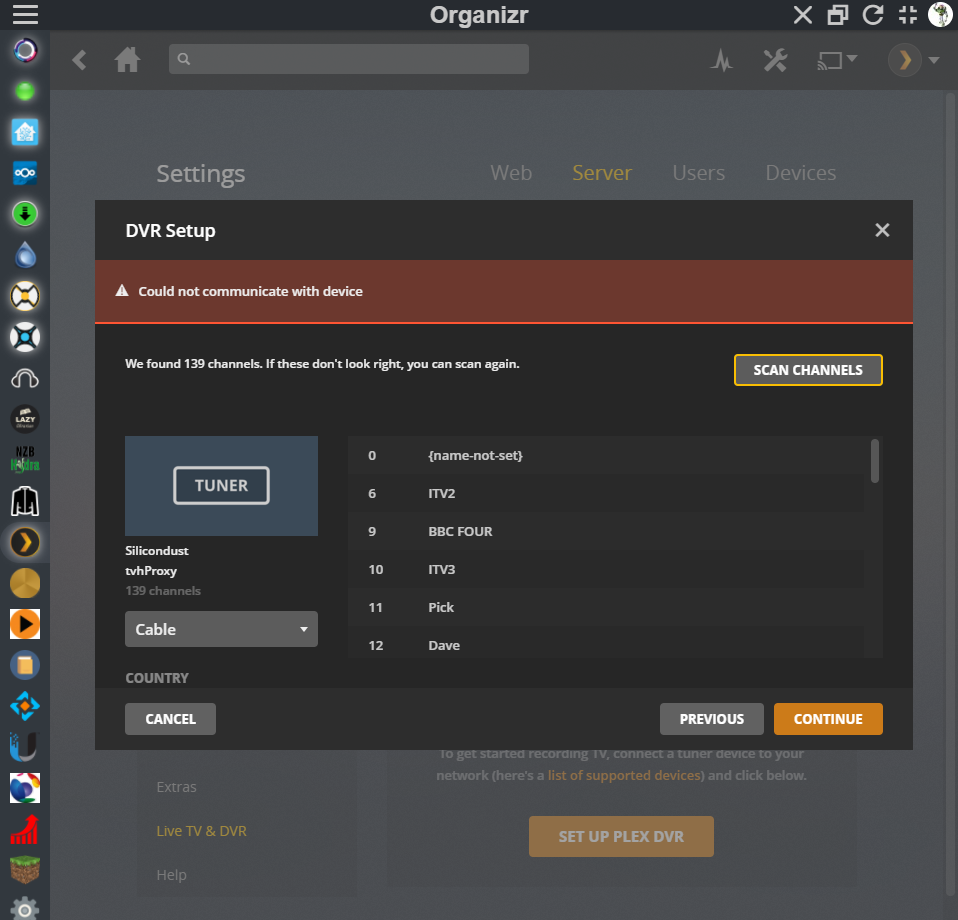

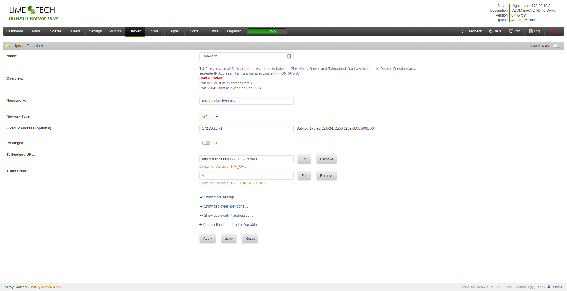

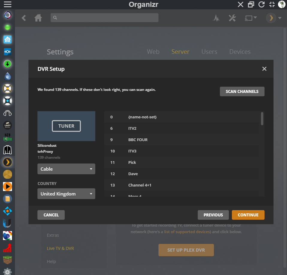

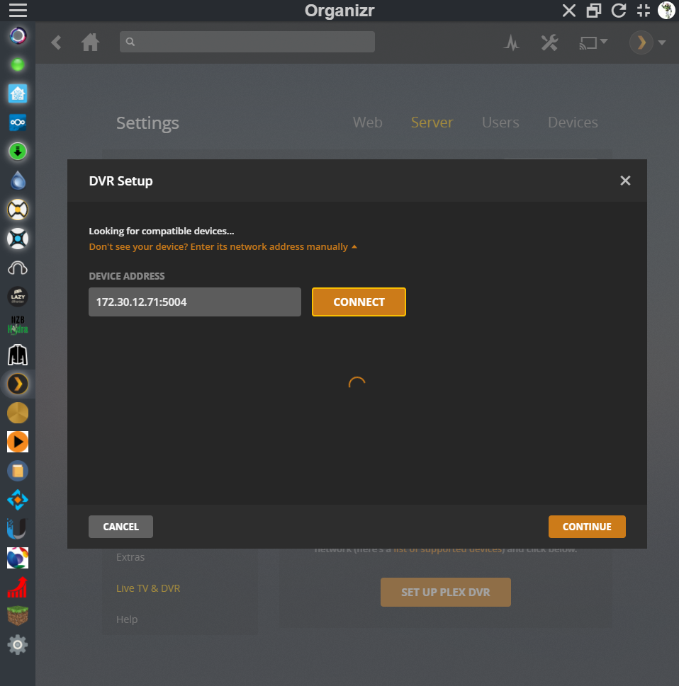

I've setup TVHproxy and all seems correct as it picks up my tuner, epg etc.  But when I try to watch a live show I get 'Playback Error Unable to tune channel'  I tried doing a recording as well, but when I go to Recording Schedule to check it says ' Transcoder error' net to the recording.
Do I need to setup a particular profile or change any settings in TVH other than creating a user for Plex to use like I have?
Thanks
Update: sorted.  my new plex profile wasn't using pass as the streaming profile.
@chvb help please!  tvhproxy looks like it's connecting to TVH ok as it's picking up my channels, so I think the proxy-plex bit isn't working for me.  I've taken screenshots so hopefully you can tell me what I'm doing wrong.
imageproxy.php?img=&key=00b562fcac28e727
FireShot Capture 43 - Highlander_UpdateContainer_ - http___172.30.12.2_Docker_UpdateContainer.png
Edited by DZMM
