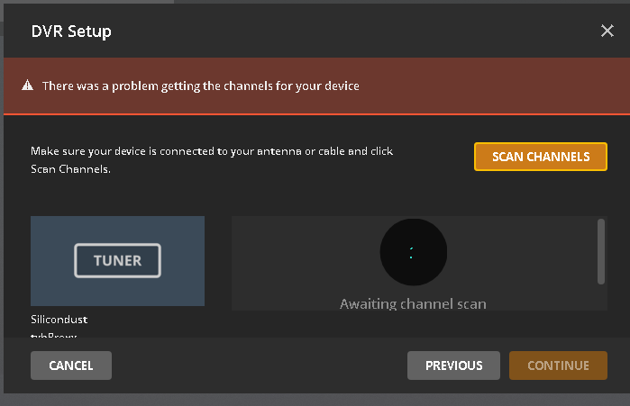

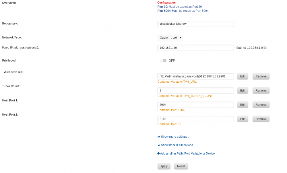

Hi Rick or anyone who can assist, can you see anything wrong with my settings?
Have subbed out my username/password in the TVHeadend URL...The logs in unRAID for this container show the below.
It does appear to be listening on 5004 as Plex can connect to it but I just get "There was a problem getting the channels for your device"
EDIT: Changed Host Port 2 to port 80 but have the same issue still
Edited by itsdandandan

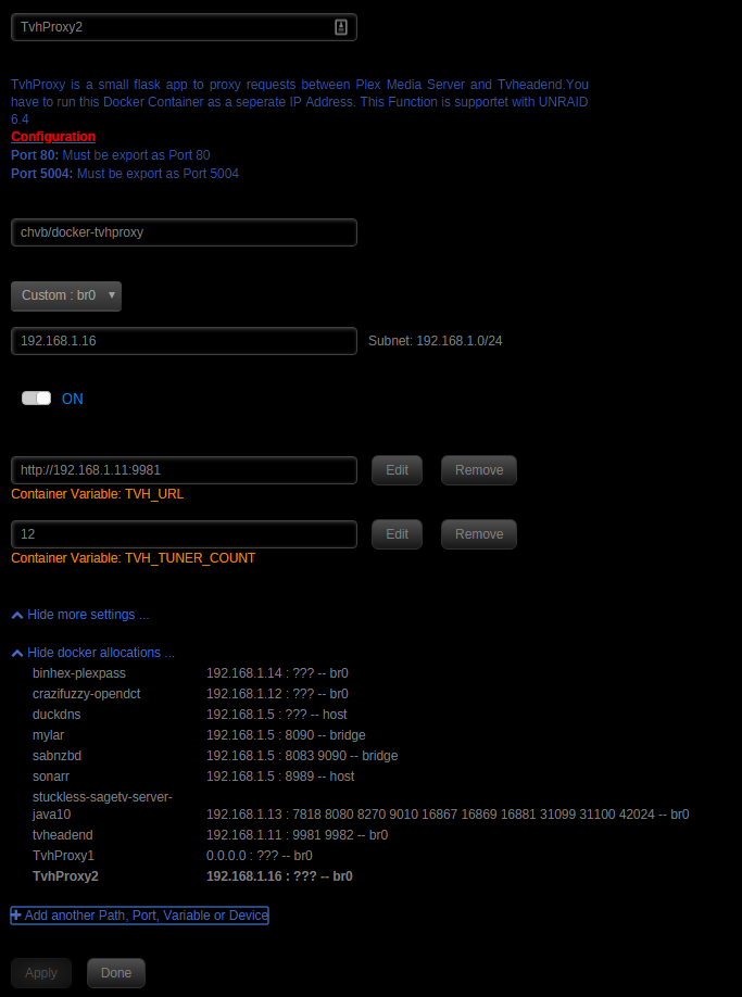

Comparing to mine, you seem to have extra settings in tvhProxy - I don't have any host ports defined. Also, it may be worth trying it without username/password on tvhe.

It never shows anything in network, doesn't stop it working.
It always uses the same ports, as it says in the container:
"Port 80: Must be export as Port 80
Port 5004: Must be export as Port 5004"
This is what the container does by default, no need to add, and you add it in Plex as 192.168.1.nn:5004. Once added Plex often says it's not found, but it still works.
Hmm removed those extra settings I added and the username/password bit but still having the same trouble when adding it.
You have the channels configured in tvhe? Obviously it doesn't really need to scan. I don't remember this stage, it was a few weeks ago...
