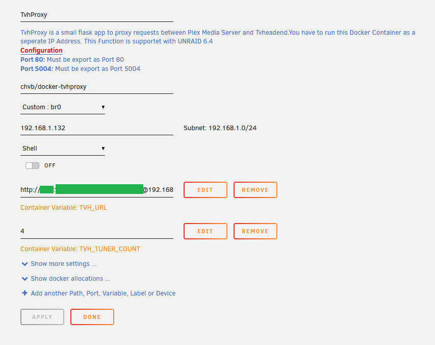

Hi
I have setup the TVHProxy container and Plex sees it as Silicondusk tvhProxy tuner.
I just get an error "There was a problem getting the channels for you device"
Is there a configuration setting on TVHeadend that i am supposed to set for it to work.
I have tried different TVHeadend users but make no difference.

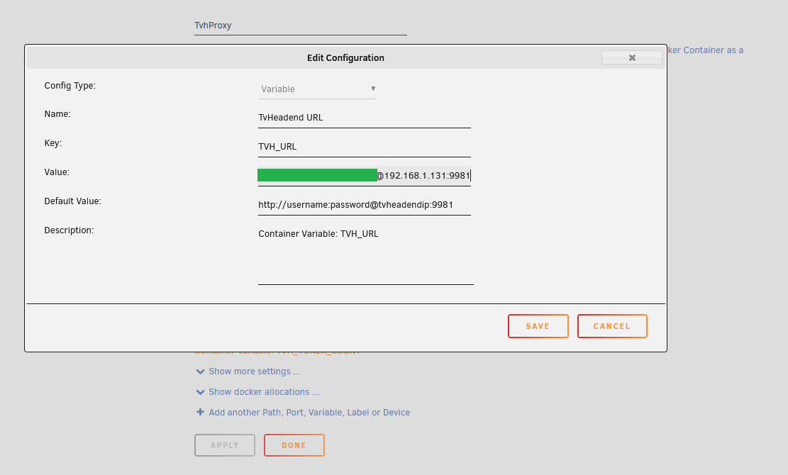

+1 on this error. Plex sees the TVHproxy tuner, but "There was a problem getting the channels for your device" when you try to scan.
Exact same error log in tvhproxy too. @Stealth1081 Did you end up finding a fix for this?
  • 2 months later...
Just worked out the fix for this - you nee to enable basic authentication under the base config tab:
the proxy will then be able to connect and it should all work straight away.

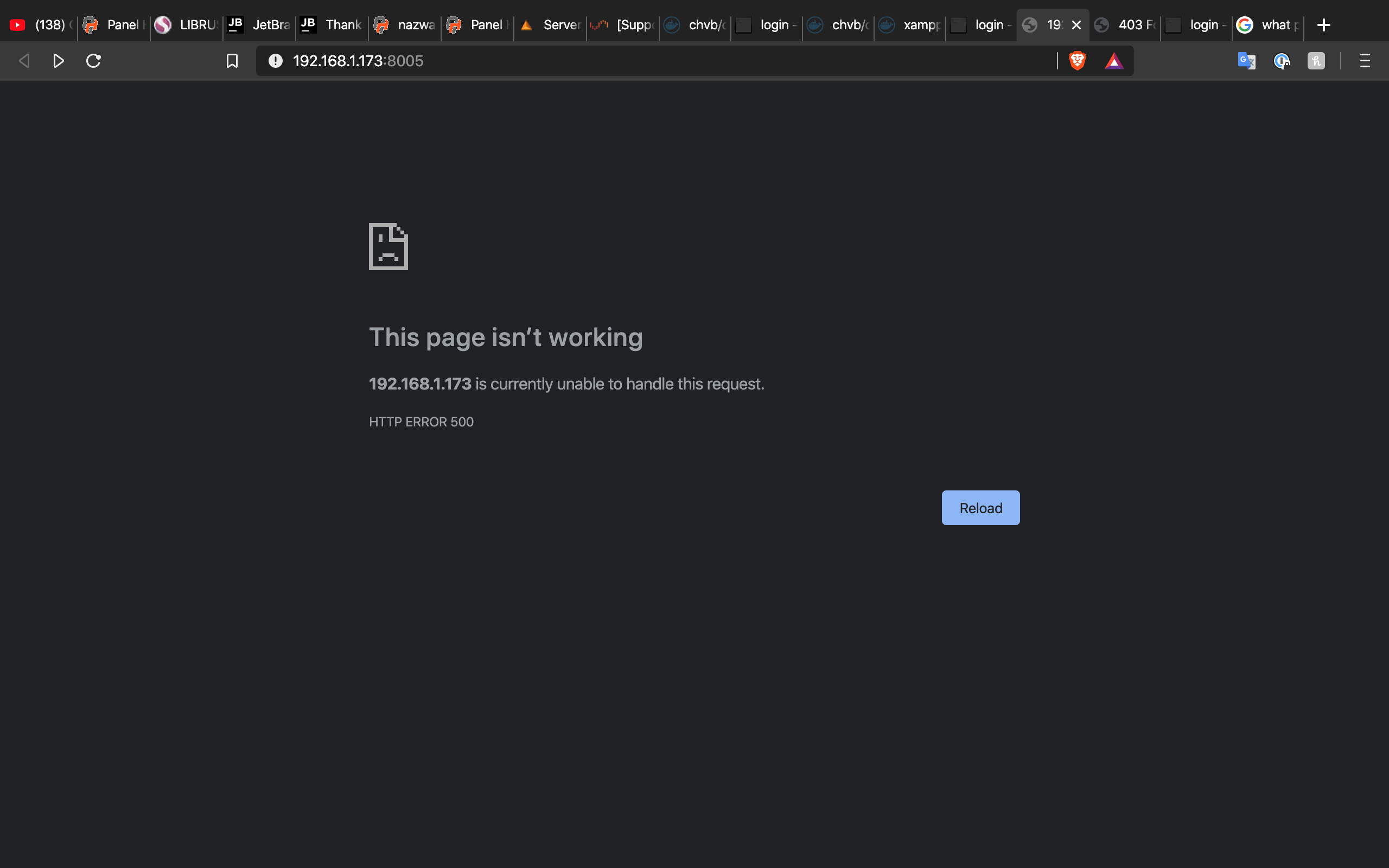

I am needing to use tvhproxy so plex can use the tuner but when i type in the ip of tvhproxy in plex it doesn't show anything up. Been trying for a while as tp what it is and I can't think of anything.
any help much appreciated
thanks
Error log from TVHProxy

An error occured: ValueError('No JSON object could be decoded',)
[2019-06-13 14:44:34,158] ERROR in app: Exception on /lineup.json [GET]
File "/usr/lib/python2.7/site-packages/flask/app.py", line 1982, in wsgi_app
response = self.full_dispatch_request()
File "/usr/lib/python2.7/site-packages/flask/app.py", line 1614, in full_dispatch_request
rv = self.handle_user_exception(e)
File "/usr/lib/python2.7/site-packages/flask/app.py", line 1517, in handle_user_exception
reraise(exc_type, exc_value, tb)
File "/usr/lib/python2.7/site-packages/flask/app.py", line 1612, in full_dispatch_request
rv = self.dispatch_request()
File "/usr/lib/python2.7/site-packages/flask/app.py", line 1598, in dispatch_request
return self.view_functions[rule.endpoint](**req.view_args)
File "/opt/tvhproxy/tvhProxy.py", line 54, in lineup
for c in _get_channels():
TypeError: 'NoneType' object is not iterable
::ffff:192.168.1.125 - - [2019-06-13 14:44:34] "GET /lineup.json HTTP/1.0" 500 431 0.006466

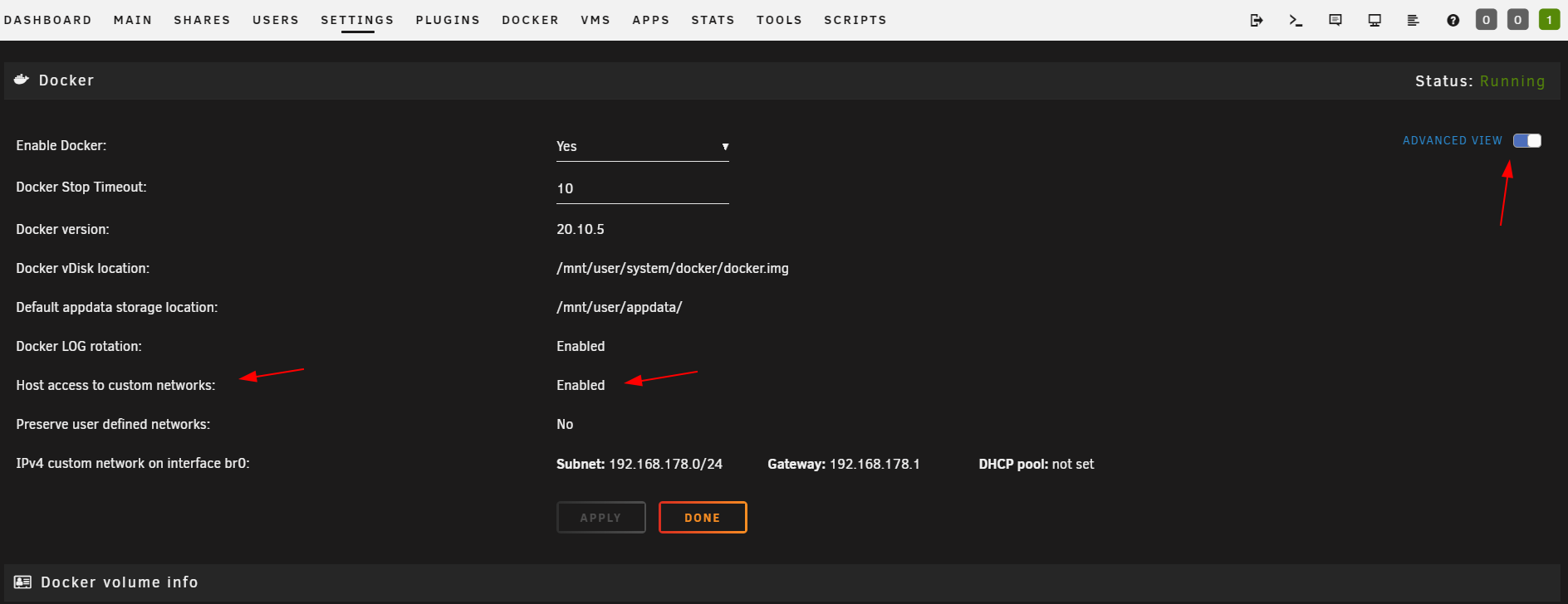

i dont use tvhproxy anymore for this usecase as i switched, but may some points
docker settings in unraid, allow network access to host should be enabled so plex and tvhproxy can comunicate
and about tvh usage with password, read about it howto, there where some steps to take sometimes, read about auth type plain and digest, has nothing todo when using the web gui but when using apps or scripts to fetch the m3u.
