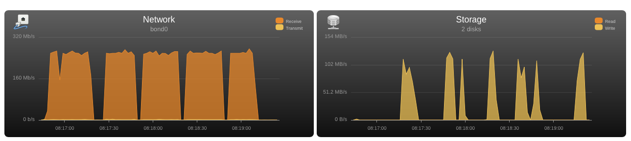

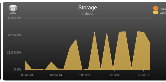

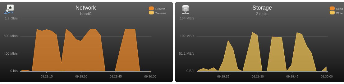

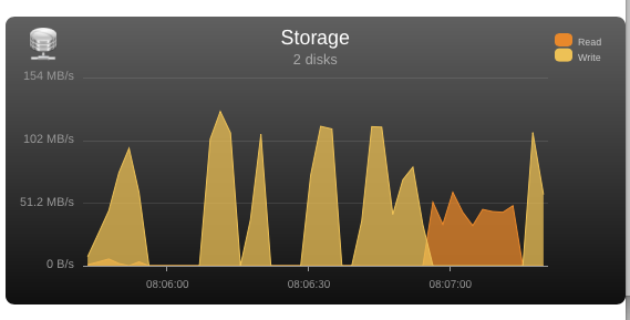

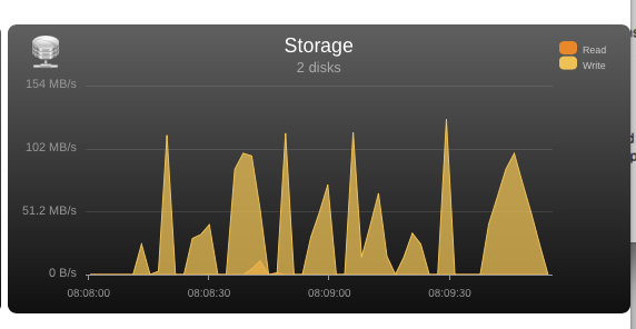

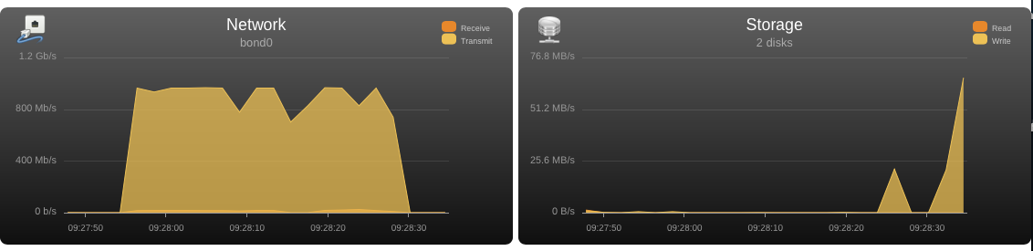

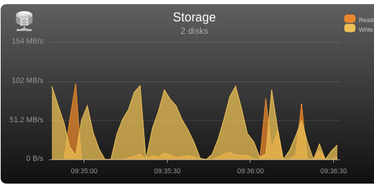

I was reading that at times you can't trust the listed speeds in the vm, so watching them via unRaid shows huge swings when writing to cache or NAS.
I've attached screenshots from a 3.75GB files transfers.
When going from NAS to OS X vm, it appears to receive data (not at full gigabit speed) then pause receiving and write to the cache disk.
When transferring data from the vm to cache and back, the same write cycle appears.

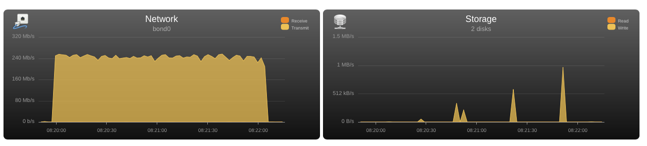

So now the win 10 vm is acting up. :o
It cycles writes to the virtual disk just like  the OS X vm, but not when sending to the Nas.
So am I hitting some sort of network or write buffer on the machine or unRaid software? The ssd is maybe 2 months old and seems to be fine so I'm not sure that is the issue.
