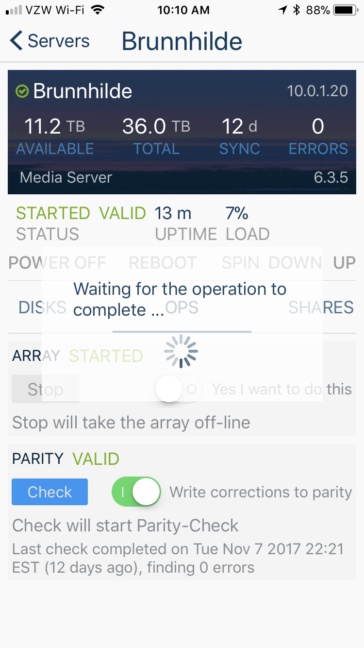

Looks like I have run into a bug. Used this app to reboot my server and now it’s hung on this screen after the boot completes-
I can’t go back. The only option is to force quit the app.
Edit: Only happens if you close the app before the shutdown process completes. If I just leave it open, no issues.
Edited by wgstarks
Oh ok, that sounds better.
What's probably happening is that when you open the app back again, it sees the server is (still) up, since it has already rebooted.
The apps waits a bit for the server to go down (reboot/powerdown), by checking if it's still online.
I've reduced the time it waits checking for this, to about 4 min. I'll probably lower it a bit more.
Probably a good idea. Otherwise you have to wait for the shutdown to complete (about 60 secs for me) before you can close the app.

I haven't been able to reproduce the issue mentioned by wgstarks (I can switch to another app and when it resumes, the waiting ... message disappears, it doesn't crash).
But I'll be doing some further checks on the matter.

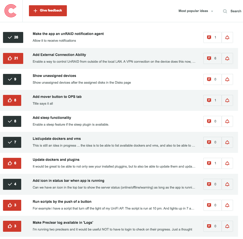

Attached is a screenshot of the top 10 requests in the feature request board
I'm skipping make the app an agent (a bit complex for the moment) and show unassigned device (this plugin could easily be an app by itself).
I'll work on adding mover and sleep buttons next.
Actually, I didn't get a crash. It froze. and only if I didn't wait for the shutdown to complete (~30 seconds (ish)).
I can see I'm going to need a bigger phone to make room for all the buttons. :D
