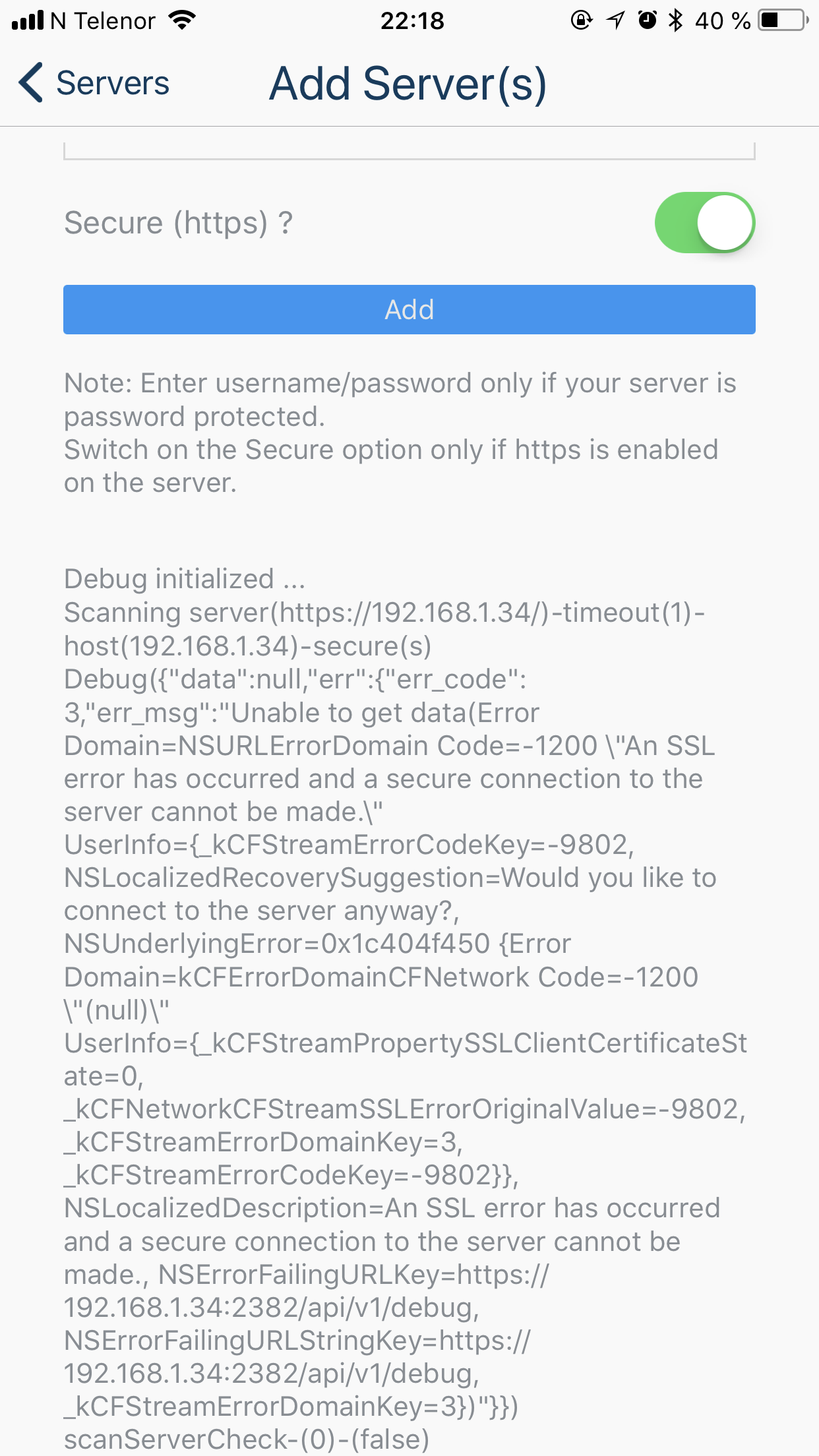

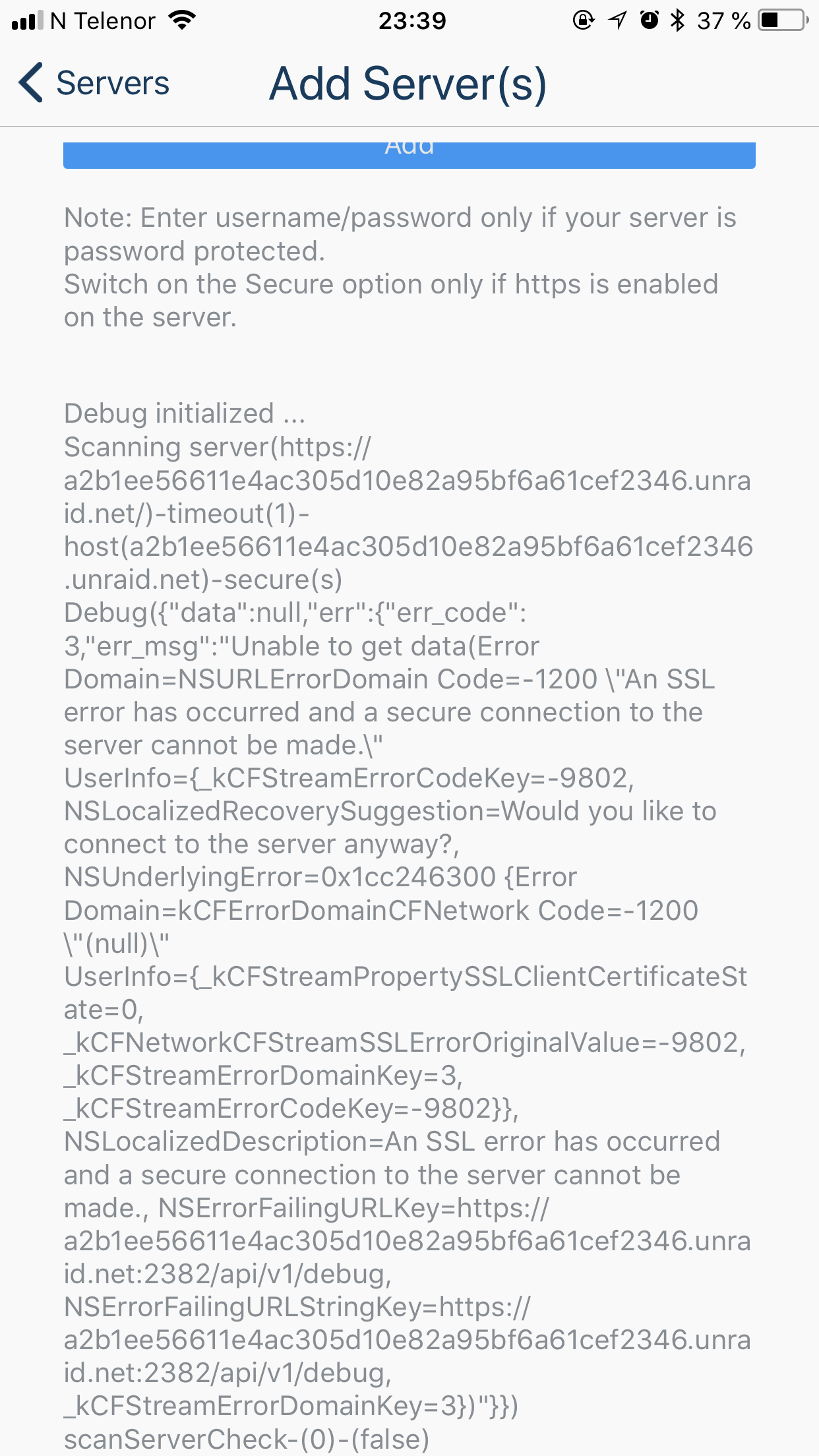

Ok, try this next
- Go to Settings > Credits
- After the react native credits, you’ll find a debug button, hit it once (counter should read 1)
- Now try connecting manually (you should see a ‘debug initialized ‘ message at the bottom)
- It should go back to the main screen
- Go to manual add again
- It should be displaying some debug message
- Take a screenshot and send it over (pm if you prefer)
Also, by any chance, in the hostname, you're not entering the https:// prefix right ?
2 hours ago, jbrodriguez said:
Ok, try this next
Nope only ip, no scheme.
Thanks GilbN !
One last test and sorry for the inconvenience ... can you add the server using the fqdn (xxxxx.unraid.net), 443, secure checked (from within your lan) ?
Please leave debug on to check the possible error.
P.S.: Also, what iOS version are you using ?
Edited by jbrodriguez
21 minutes ago, jbrodriguez said:
Thanks GilbN !
Using 11.4
Thanks !
One of those 2 should have worked (ip vs fqdn).
I'll add another iOS flag (which I should have added anyway) and do some testing to publish an updated app.

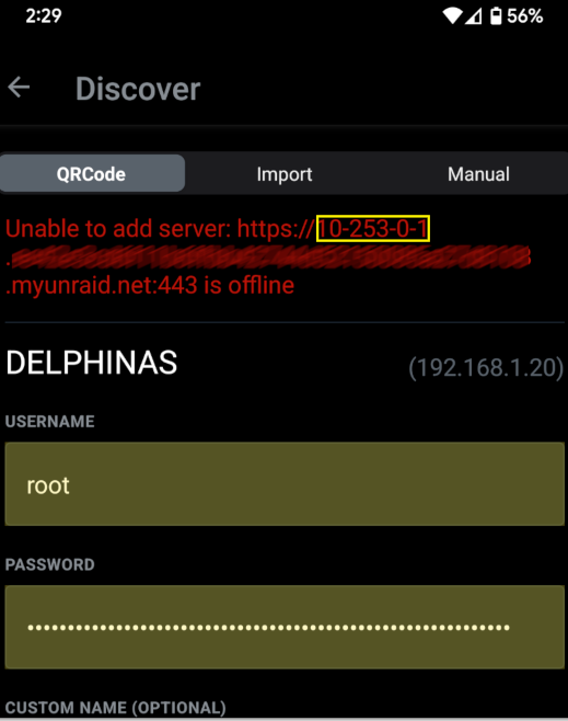

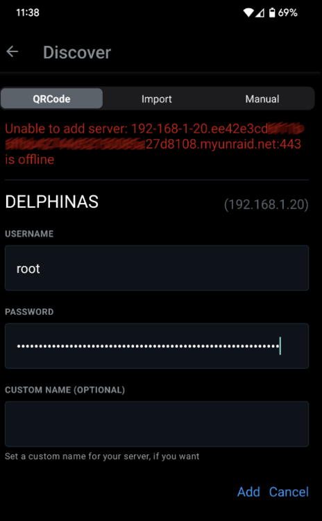

23 hours ago, GilbN said:
Hi, just bought the app and installed the companion plugin. I'm trying to connect via a vpn connection. I can access unraid just fine using safari but nothing happens in the app. No error messages or anything.
Tried on port 80 and 443.
Tried with and without https check.
tried with IP and the custom unraid dns.
I'm getting the same thing - hit the button and nothing happens. I just emailed the dev about it then realised I could just check the forums.
