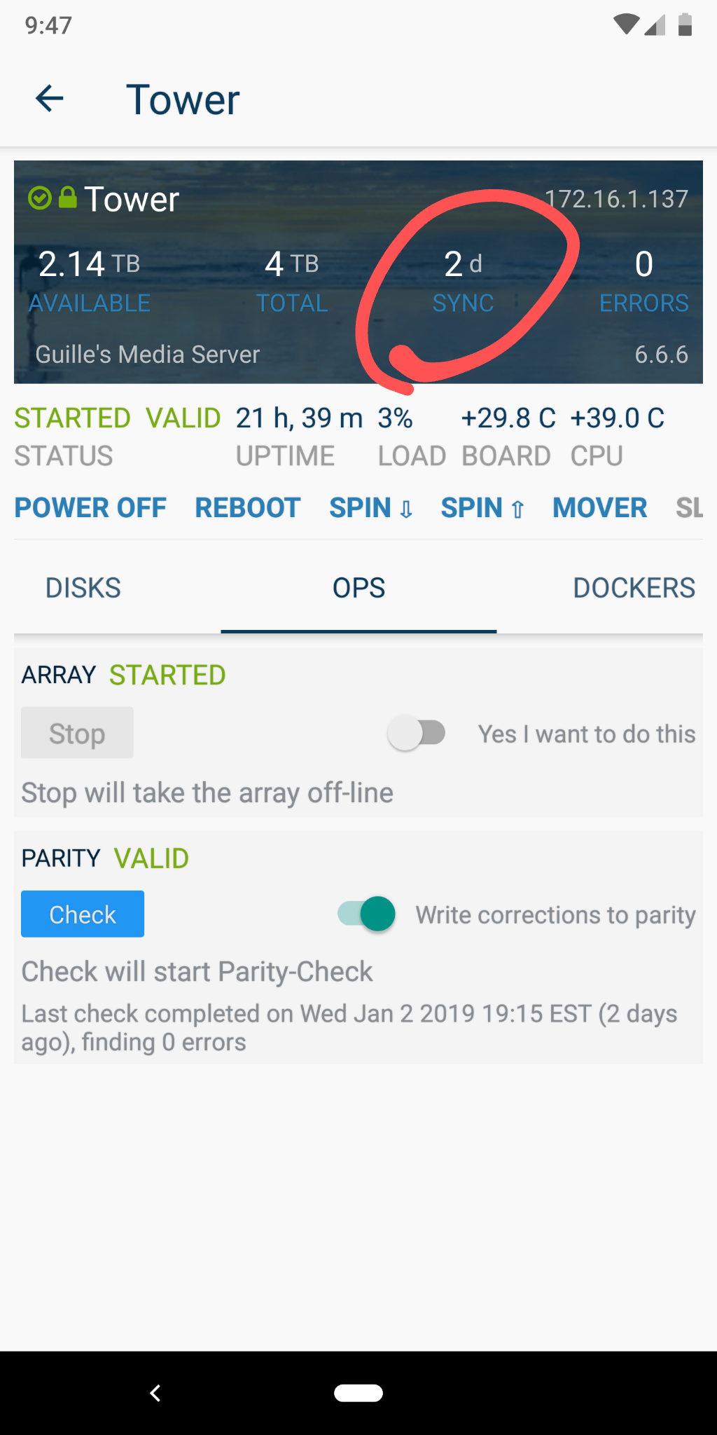

What means sync in the app It says 2D
Your last parity sync was 2 days ago

    Yes, this one is a bit strange, I'll need to dig deeper to figure out what's the issue
Awesome! thanks

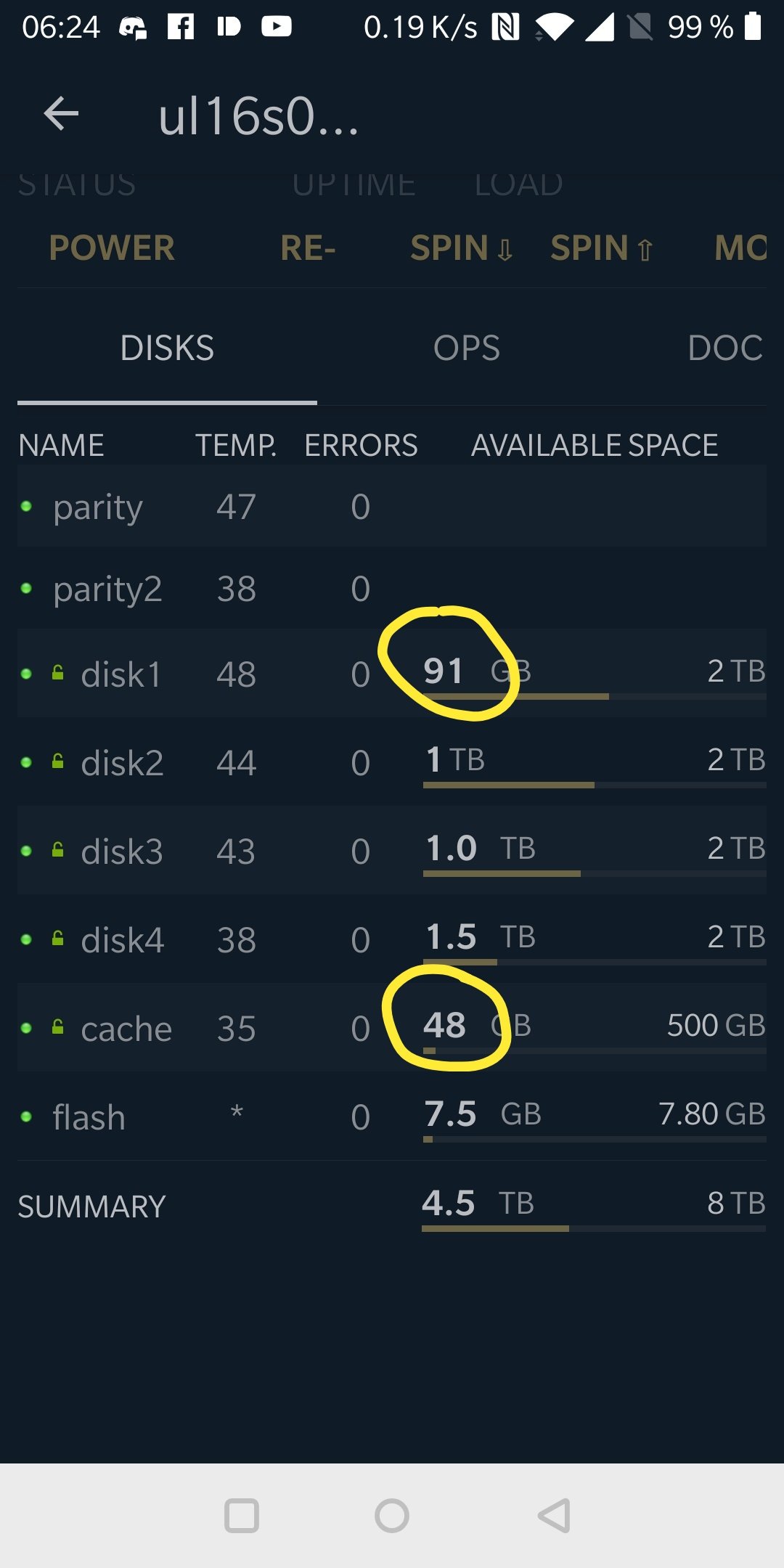

somehow the space used on disks isn't always displayed correctly... the last digit seems to be cut off, regardless of which font size I use... the numbers in the Screenshot should be 912 GB and 481 GB respectively...
17 hours ago, jbrodriguez said:
Hi, thanks for the report.
Would you mind following the steps in https://github.com/jbrodriguez/controlr-support, so I can reproduce the issue with the same data ?
Certainly, just sent it off.
After reviewing the issue with drdebian, we found it's an issue with the default font in some Android devices.
Setting the system-wide font to Roboto fixes the issue.
I'll be doing some additional research into the matter, but will probably offer an option of using Robot for the app, at least.
