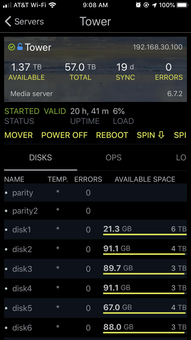

Thanks for the app. I am trying to get my NUT stats to display. Am I missing them?
iOS 13
ControlR v4.10.0
NUT Plug-in 02-03-19
unRaid 6.7.2
Do I need the ControlR plugin for NUT stats to work?
Thanks

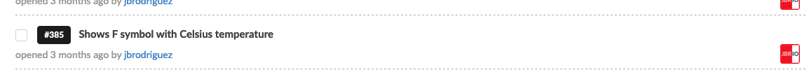

Good evening,
Do you have any updates on the temperature bug I reported about three months ago (#1006)?
I updated to the latest version and the issue remains.
Thank you,
Erik
Sent from my iPhone using Tapatalk Pro
<snipped>
When I was posting the updated version I came across your post about this issue.
I have it open in my gitea host (see below), just haven't been able to get it.
It should be a quick fix (I think), so I'll work on it once I have preliminary 6.8.x support.
And thanks a lot for the reminder (and patience) ! :)

1 hour ago, ErikM1970 said:
Good evening,
Thank you,
Erik
 I replied on the wrong post but the idea is the same :)
Thank you!
