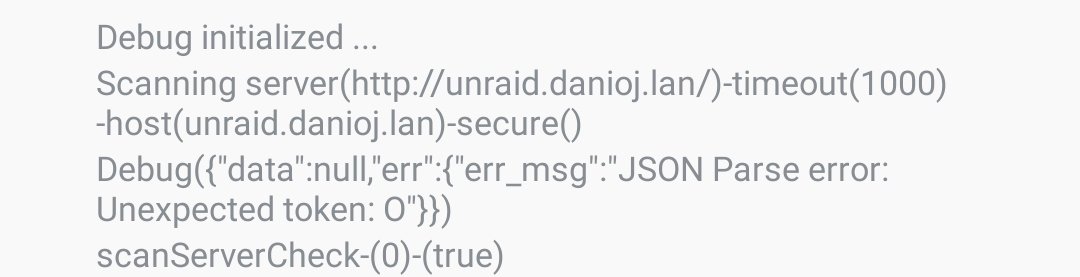

Trying manual add, results in the following:
EDIT: Googled the error, reckon it is a special character parse problem. Given the complex password I use I'm guessing your gut feeling is right.
EDIT2: if it helps, I'm willing to change my password and share the password that doesn't seem to be working to help debug. It's auto generated by the password manager anyway so no bother.
Edited by danioj
Hi, the JSON parse error is about the ControlR plugin, I think it believes you're on https, while you're actually on http.
There should be another debug line below the scanServerCheck.
Can you try setting your Unraid SSL setting to 'no', just to check if that solves the issue ?
Hi, I did as you asked. My SSL setting was Auto (as is the unraid default I believe), i set it to 'no' as requested and tried again. The result was identical. I won't post the image again as it was literally identical, down to the unraid log of unsuccessful login.
You mention that there should be another debug line, there is not. I have tried scrolling, copying etc, and nothing.
