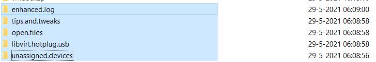

I must notice that i do remember 3 days ago, a bunch of plugins where updated.
Soon after that the problem started with the app's screen turning white...
i think it were these plugins:
Edited by Dantheman
