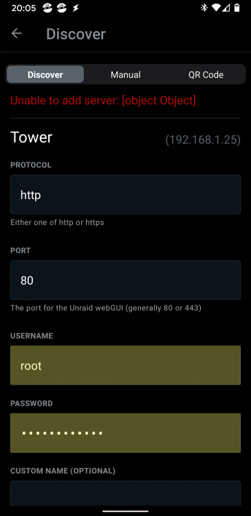

I can't add my server, keep seeing a weird error as per screenshot.
Thanks for the screenshot, I need to improve that error message.
Can you confirm you're not using SSL and your webUI is running on port 80 ?
Can you restart the controlr plugin and try again ?
Hi, I've tried a restart and a reinstall of the plugin but still the same issue.
I don't use SSL and use port 80 (I'm running 6.9.0)

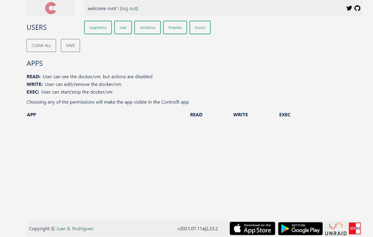

On the GUI I don't see any dockers or VMs:
Edited by fireplex
