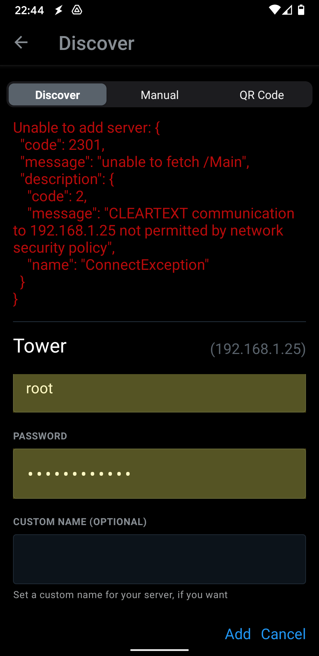

Here you go below.
Perhaps https://developer.android.com/training/articles/security-config#CleartextTrafficPermitted ?
I am running Android 11 on Pixel 3A.
Edited by fireplex
Yep, that flag got lost in the rewrite. I put it back in 5.0.2, hopefully that solves the issue.
