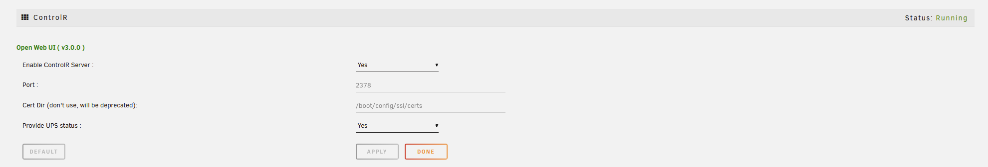

I have the plugin enabled and the app works, however I don't see my UPS and the log section is empty. I made sure the plugin is enabled in my server settings as well. I don't see temperatures or fans either so I figured if works as if the plugin wasn't installed. What's wrong?
Also, any plan to add notifications? I tested another app called Array that currently has notifications and UPS data with no plugin. The UI of ControlR is just miles ahead however and I need the support for multiple servers as well. Honestly the notifications is the only thing missing from ControlR IMO.
Edited by dnLL
I restarted the plugin and it now works. Any plan to add notifications?

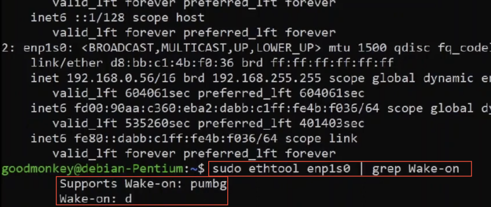

My question is about the WOL feature. Unfortunatelly, when my server is in sleep mode, when I press the "power on" button, it just says something, that I have to wait until the command finishes, but the server doesn't start. Does anyone know what is the reason and how to fix it?
Here is my setup:
S3 settings:

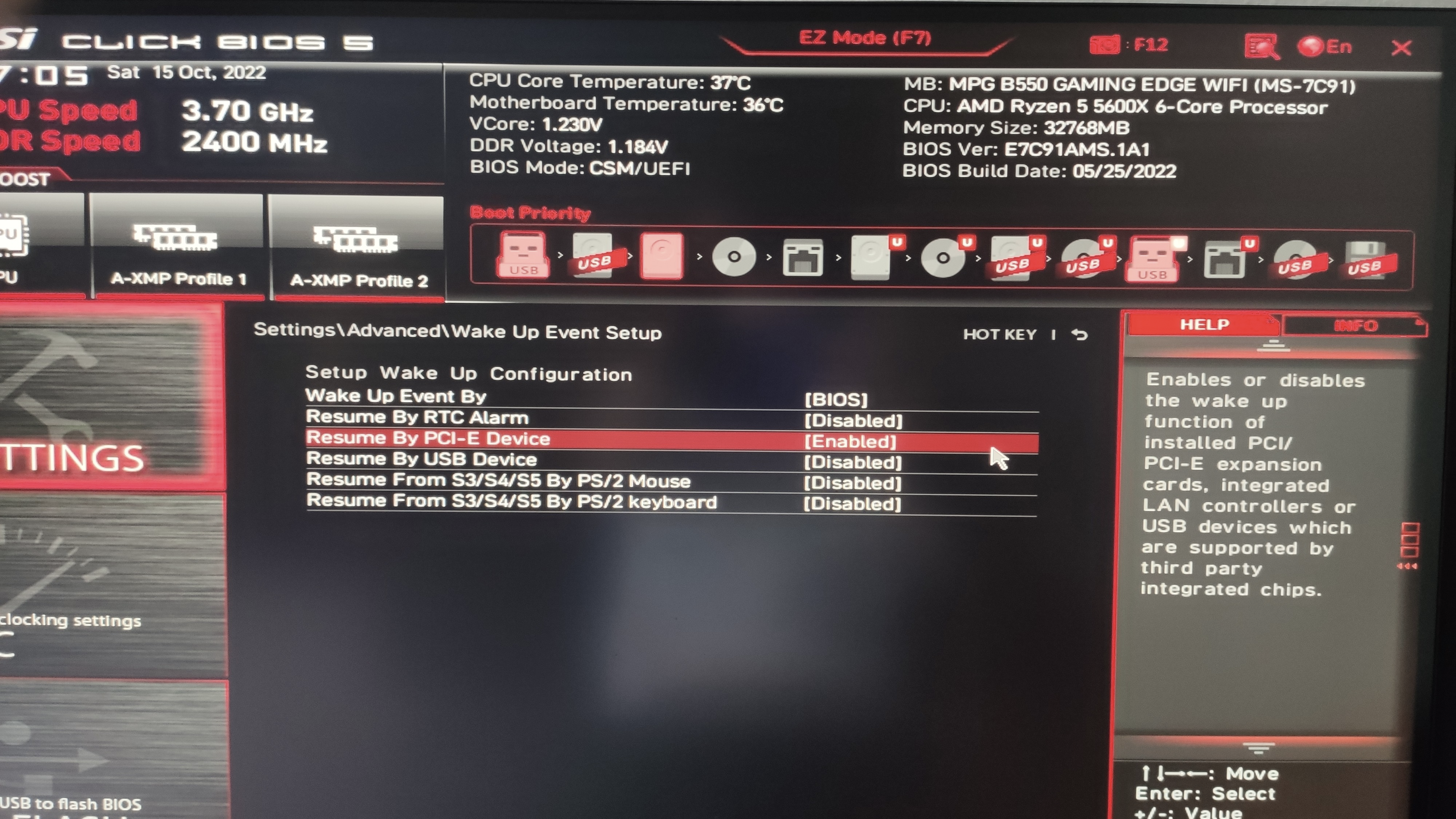

BIOS settings (MSI Motherboard - checked online what settings have to be modified in order to get WOL working):
ERP ready -> Disabled
Resume by PCI-E Device -> Enabled

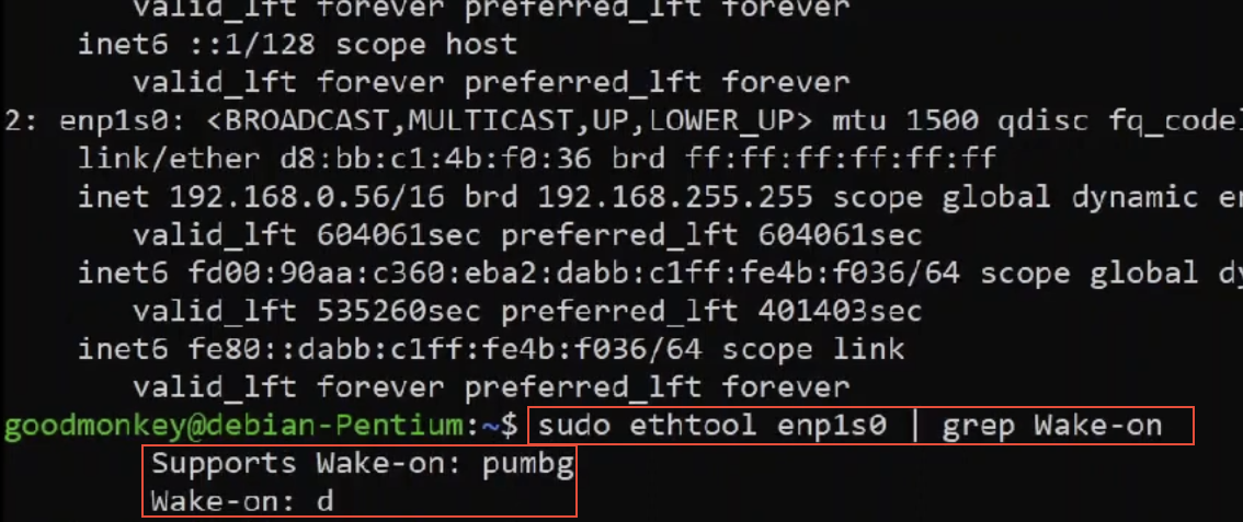

Then I've checked this video (Setting Up Wake-On-LAN with MSI Motherboard and Linux):
And inside Linux he is using commands like
* sudo apt install ethtool
I've done ethtool -h on the console, and got result, so I think it is already installed and skipped this step
* ip address
In order to find the correct adapter name. In my case I have dozens of them, but it seems that br0 is the correct one (is at least the one which is showing the IPv4 of the server
* then he uses "sudo ethtool [NAME OF THE ADAPTER] | grep Wake-on
and he sees which states are supported and what is set.
When I do it, i don't get any results:
But on the other hand, I don't know what is "normal" for unraid, and maybe this is something the ControlR Plugin and app is handling?
Thanks for any advices.
Cheers

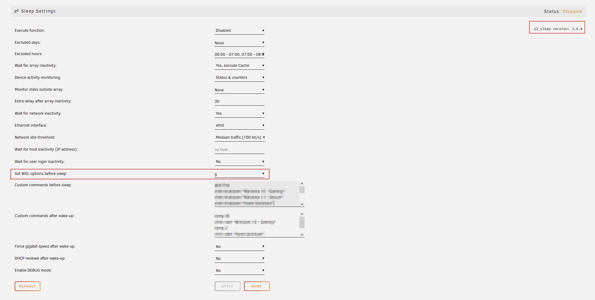

EDIT SOLUTION:
Alright, I've managed to finally find the reason and solution. Luckily I stumbled upon this post: https://wiki.unraid.net/Setup_Sleep_(S3)_and_Wake_on_Lan_(WOL)
The WOL feature is running in unraid on module eth0 and not br0.
If you type "ethtool eth0" you'll see if your Wake-on is actually on and in addition what ckind of Wake-on are supported. It has to be a "g" as in f.e. pumbg listed. Each letter represents a wakeup option.
In my case I had Wake-on for eth0 on "d" for disabled (I guess). It can be switched with this command "ethtool -s eth0 wol g" (g stands for magic packet). After sleep and wake-up, this "g" persisted.
Edit - Edit: it did not persisted after reboot of the unraid system. so a script has to be added which will "reactivate" wake-up - g each new boot, but in your case it might work just fine. I've solved it with a custom script plugin which run's this "ethtool -s eto0 wol g" command at array start, which should mostly be when the server reboots.

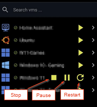

Ah, thanks for the reply. This is changing the whole thing drasticly. Is there maybe a roadmap for new features? For example to force stop a VM (like my issue post today)?
if the web ui offers that option, it should be available in the app, if it's not in the app, it shouldn't be too much of a problem to add it
Ah great, yes it is in the webUI but not in the app. In this case I'll just wait for the next release.

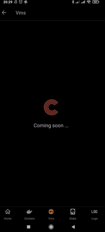

Hi
Thanks for update and reply. Unfortunately I don't have neither destroy, nor force stop -> destroy would be fine too. I am using Android version.
When I click on VM details, I got this message:
