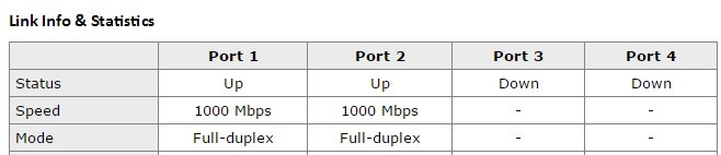

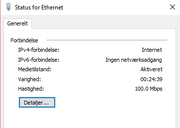

This is Soooo embarrassing  :-[
Lol, my Danish is a little rusty (well, non-existant) but I do recognize 100 Mbps - that will do it ;).
You found the culprit :)
Now you just need to find out Why it is only running at 100 mbit
You said earlier your router was a Gb router => have you confirmed that?
If so, note what I said earlier ...
... But your real issue seems to be that your network connection to the laptop is only 100Mb
... and the easy resolution to that:
...  If your router has Gb ports, then most likely the laptop only has a 100Mb adapter.  (In which case you'll need to add a USB Gb adapter to get better speeds).  http://www.amazon.com/StarTech-Gigabit-Ethernet-Network-Adapter/dp/B0095EFXMC?ie=UTF8&qid=1465491393&ref_=lp_13983791_1_15&s=pc&sr=1-15
Yes the Router is Gigabit, the same goes for my two switches.

I flipped my laptop and found the model number. Found the model om HP's homepage. And it says it clear as day. 10 and 100 mbit. So my laptop has been the slow part all along.
