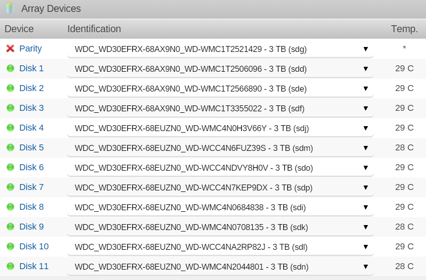

The server had many spec, evolving with my problem but this is the final build and my last problem is that I have a drive that report faulty after a week or two in the best of time. See with my log.

- What troubling me the most, yesterday I received my new rack to replace the one that was faulty the problem was still present on disk11 (lsi card). I done a new config because I'm out of idea and now the problem is back on my parity drive (on board)

Both the smart report and the syslog indicate that your parity drive has dropped offline so no information can be found for it.    You probably need to power cycle the machine to get the SMART information.

Following your hint about the power supply I done some modification to the wiring and removed some molex splitter to the hdd cage. I used some good quality splitter but it seem to be a good advice because I was able to rebuild the parity drive without error.
Now only time will tell if it was the problem since the begining. I was so blinded by the problem I got that I never looked at this side of the problem.
