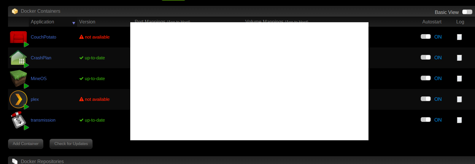

Hey guys,
So update on the Docker updating error. I have since verified that all containers exhibit this strange behavior, and not just Plex. Whenever I click the blue 'Update Ready' button, it appears to be pulling Docker images from the web, extracting them... and then installing it. But then there's no step for deleting the orphaned (deprecated/old) image.
And then the icon turns red. See the screenshots for details. This only happens to CouchPotato and Plex; MineOS doesn't even display "Not Available" and just goes to Green until I press the check for updates button.
I have posted screenshots (with personal info removed) and diagnostics. Would anybody check, please? Thanks.
derrickserver-diagnostics-20160704-1448.zip
Known bug (as was pointed out to me yesterday).  Kill the docker image and start again.
Thanks. Appdata is stored away from docker.img, so it should be safe, right?
And how should I nuke? Tell me if this is incorrect.
1. Stop Docker service thru Settings
2. SSH into server
3. Delete docker.img... where? Is it in /flash or something?
4. Restart Docker service thru Settings
5. Install Docker containers again.
EDIT: Just saw the option on Docker settings. No need for SSH or anythng. Thanks for the help!

Is there a plan to update this docker, or is it no longer supported?
limetech's Plex docker app was updated to version 1.0.0.2261 on June 29th...
Thanks eschultz.  Sorry for the stupid question, I'm still kind of getting the hang of dockers, but what's the preferred method of updating plex?  The docker app was not showing any updates, and a manual restart/shut down/start up of the docker was not working either.  I did finally get it to work by using the force update recommended above.  Is that the best way to do it from here on out?
The next release of unRAID 6.2, rc1, will properly show when a docker update is actually available so you won't have to do a 'force update' any longer after that... or until Docker changes the Docker Hub API schema again (which is what broke these status updates for some of the latest docker containers this time)

Oh my god, it happened again.
The Docker update bug. Do I need to delete the image again?! This is so frustrating!
I mean, once is enough, right? When is this going to be fixed?
Yeah.. still happening for me. Annoyance factor is high, but really not a game stopping bug.  Gotta love betas ;)
