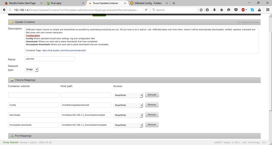

yeah, but within the settings for you d/l client, you've got to tell it to store the incompletes within /downloads/incomplete, and the completes to /downloads/complete.  If you're telling the dl client to store them within /mnt/disks/192.... then it'll be storing within the docker image.
Yes remember the docker translates:
/downloads/incomplete => /mnt/disks/192.168.1.3_Downloads/incomplete
if you tell the program in the docker to use the /mnt/disks/192.168.1.3_Downloads/incomplete - that is gonna get stored INSIDE the docker container thus increasing your docker.img useage
so tell your docker program to use the /downloads/whatever paths instead and you will be fine

I think what we are missing is possibly you are using unAssigned Devices to create a share that points to another computer on the network. If this is not what you are doing then I don't understand your volume mappings.
BINGO!  very good catch.  Saw that, and it never really clicked in.
If you're on 6.2, then those mappings in the template need to be mapped using one of the slave modes (rw:slave / ro:slave)
If you're on 6.1 then you need to stop / restart the entire docker service for it to recognize those mappings.
Failure to do this may result in the files being stored within the image even though everything else looks ok.
Yes exactly right, sorry should of mentioned using Unassigned Devices to use network share as TOWER only has a single 120gb SSD no cache or parity and the mounts point to my RIG1 in my sig.

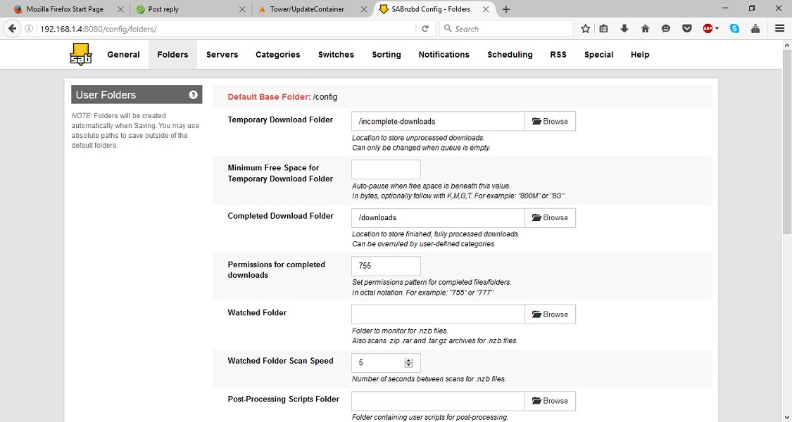

Attached some screenshots and docker have been restarted but something isnt still quite right.... Both machines are running 6.1.9 and only RIG2 has dockers installed.
Screenshot of sabnzbd config

Could be CP logs. So did what it says and no longer getting error but how do I manually check docker.img usage and to increase the size to 20gb do you do it in docker settings and hit save or do you have to create a whole new image?
If you want, delete the docker.img completely then reinstall your docker containers but don't start any of them. Note how large each one is and how much space is used in total. Then start the containers and keep an eye on rapid growth and try to see what is actually going on for each docker app.
