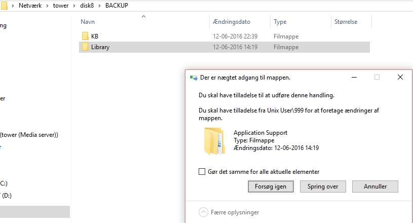

I've tried to delete the folders on disc 8 but i get this error message.
Access to the folder is made by enableing discs shares, then open disc 8 in windows 10 browser and trying to delete the folder.
But i'm getting the attached error.
Translated.
There's denied access to the folder
You need permission to do the action.
you must obtain permission from unix\999 to make changes to the folder
Hope someone can give me a hint to getting rid of this folder.
Thank you
You should stop the docker service first (Settings - Docker). If that is where docker still thinks your docker image is you might be able to just delete it from that page and make a new one on a disk, preferably cache if you have one. Then if that share is empty you should be able to delete it from its Share page.
If not, after stopping docker, you can more easily work with this sort of thing from the unRAID command line. I find mc (Midnight Commander) is very easy to use without knowing anything about Linux.
Also suggest you turn disk shares back off if you are using user shares since mixing them when moving / copying can result in data loss.
