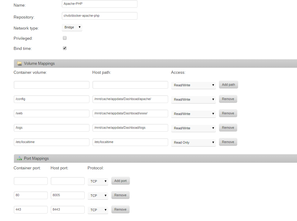

Post your apache.conf file.  With that container it could be you don't have it configured correctly in which case it won't start.  Also check the docker logs for Apache as well, might give some clues.
My money is on a config issue somewhere, also post a screenshot of how you've got the container configured.

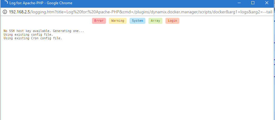

Unfortunately I have nuked the container over and over.
So fresh install with the attached config. I have also attached the container log file.
The docker log is the same and has not changed since the diagnostic I did earlier.
It def looks like its not starting but unclear why. Apache.conf is not even being generated in the config folder.
