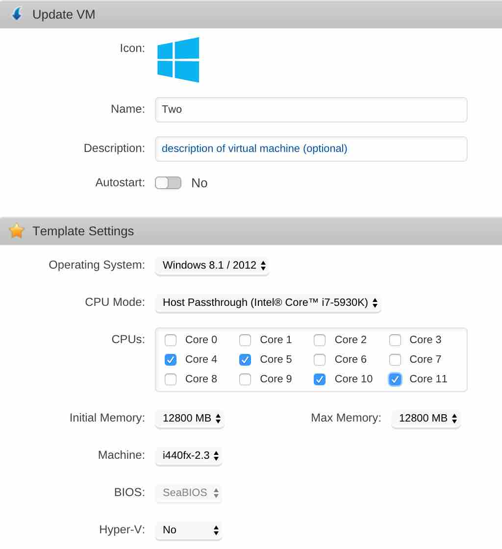

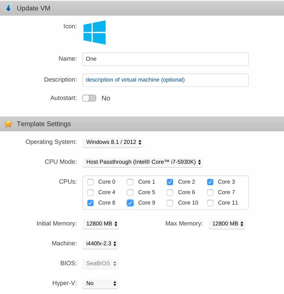

VM1:
  <cputune>
    <vcpupin vcpu='0' cpuset='2'/>
    <vcpupin vcpu='1' cpuset='3'/>
    <vcpupin vcpu='2' cpuset='8'/>
    <vcpupin vcpu='3' cpuset='9'/>
    <emulatorpin cpuset='0,1,6,7'/>   [b]<- i dont now what i have to added there. I also have to added the Core of the SECOND VM or only the           Cores i isolate for unRAID / Linux[/b]
  </cputune>
VM2:
<cputune>
    <vcpupin vcpu='0' cpuset='4'/>
    <vcpupin vcpu='1' cpuset='5'/>
    <vcpupin vcpu='2' cpuset='10'/>
    <vcpupin vcpu='3' cpuset='11'/>
    <emulatorpin cpuset='0,1,6,7'/>  <- Same Question here
  </cputune>

You have several things in your configuration that may be causing problems.
  • Set the machine type to i440fx-2.5.
  • Boot the VM in OVMF, not seaBIOS.  Your GPU must support UEFI boot.
  • Cut the memory down to 6 or 8 GB to start with and increase later once your VM is operating properly if necessary.
  • Turn on Hyper-V.
Just pinning CPUs is not enough and is probably not your issue yet.  Don't mess with CPU pinning until you have your VM running as I have specified above.  You will probably not get decent VM performance until you have done these things.  You might not have to pin the CPUs.

Hyper-V is best turned on, but with Nvidia GPU it has to be off.
Probably the most important thing is to boot the VM in OVMF and use a UEFI compatible GPU.  You can't switch this on a configured VM.  You'll have to make a new VM with OVMF boot.  Do things slowly checking your performance as you go.
I would start with no more than 4 CPUs (2 pairs) and no more than 8 GB of memory.  Over provisioning CPUs and memory can degrade performance.  Frame drops are not generally from too little memory or CPUs, it is generally a latency problem in your network, CPU context switching, background tasks taking CPU resources, etc.

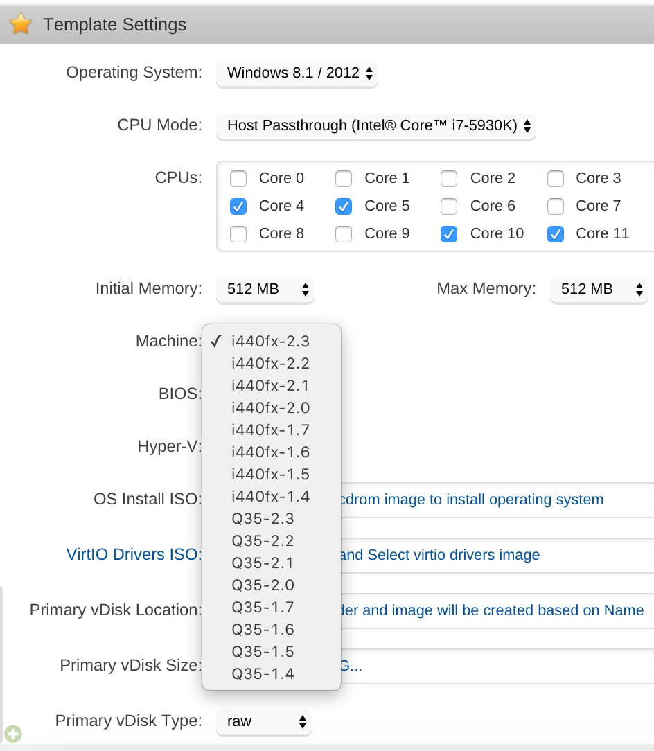

I wanted to create a new VM. But i440fx-2.3 is the highest i can setup.
There is no option for i440fx-2.5? Whats wrong ?
That's it if you are on 6.1.9.  Use that.
