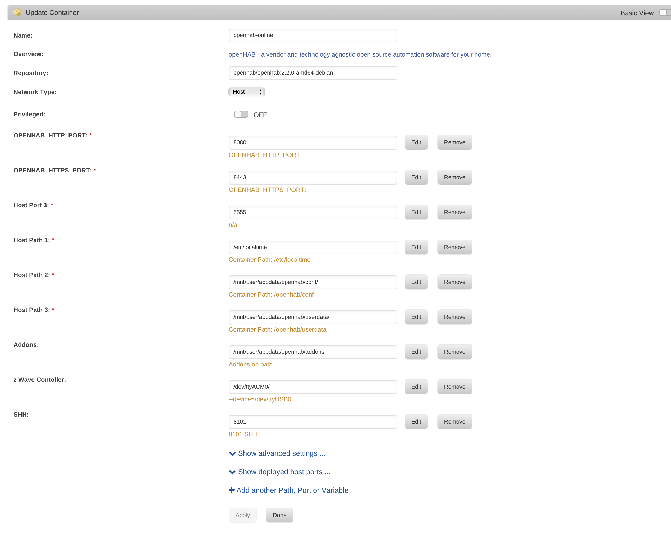

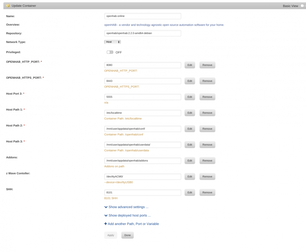

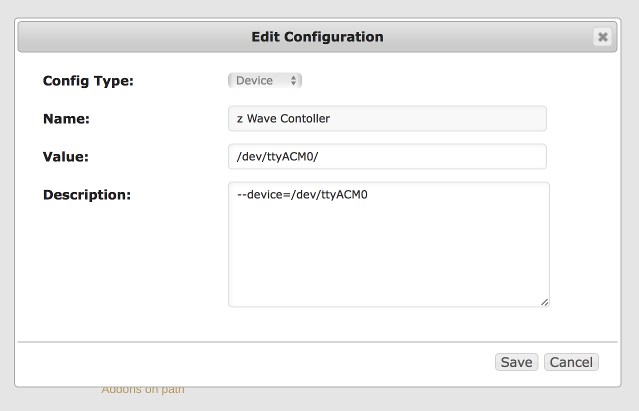

I have updated the docker container to the correct repo and other parameters... However I am having issue passing through devices ttyACMO for my system. I see it in my unraid file system under /dev/ttyACM0... Thoughts?
root@localhost:# /usr/local/emhttp/plugins/dynamix.docker.manager/scripts/docker run -d --name="openhab-online" --net="host" -e TZ="America/Los_Angeles" -e HOST_OS="unRAID" -e "TCP_PORT_8080"="8080" -e "TCP_PORT_8443"="8443" -e "TCP_PORT_5555"="5555" -e "TCP_PORT_8101"="8101" -v "/etc/localtime":"/etc/localtime":ro -v "/mnt/user/appdata/openhab/conf/":"/openhab/conf":rw -v "/mnt/user/appdata/openhab/userdata/":"/openhab/userdata":rw -v "/mnt/user/appdata/openhab/addons":"/openhab/addons":rw --device="/dev/ttyACM0/" openhab/openhab:2.2.0-amd64-debian
118c218f1697c1762e93809b5d4ad347af3e05cfc3d3544db86b069e710bc121
/usr/bin/docker: Error response from daemon: linux runtime spec devices: error gathering device information while adding custom device "/dev/ttyACM0": not a device node.
The command failed.

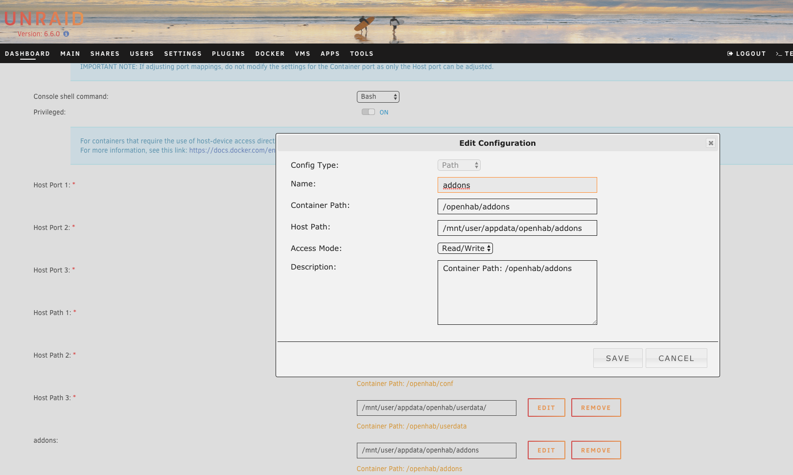

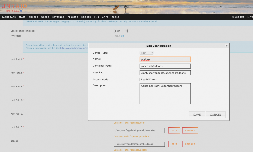

Hey! First time poster!  Be nice!  I've installed the OpenHab app, but I cannot get it to recognize the "addons" directory.  I created the "/mnt/user/appdata/openhab/addons" directory and mapped it to "/openhab/addons" but any binding files I place in it are not picked up.  Any ideas?
