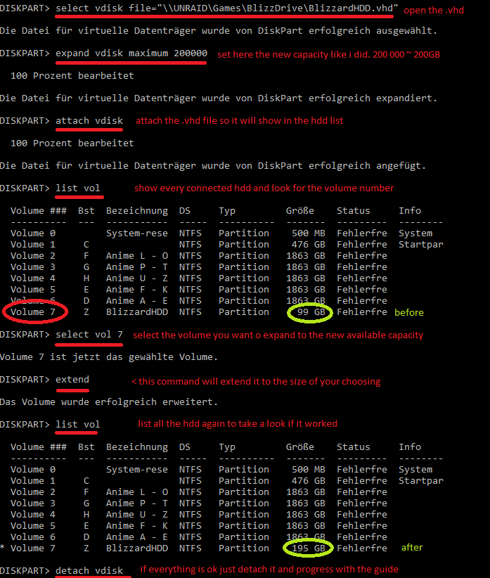

Version B - Create a small . vhd File and move it to its final destination and expand it with a few commands (faster)
Follow the Steps above but only make the .vhd a few gb big - like 5GB for example and move it to its final location on the user share.
Now you need to open the command prompt, enter "diskpart" and press enter. the diskpart cmd window should appear.
Now follow my Instructions like its shown on my Screenshot:

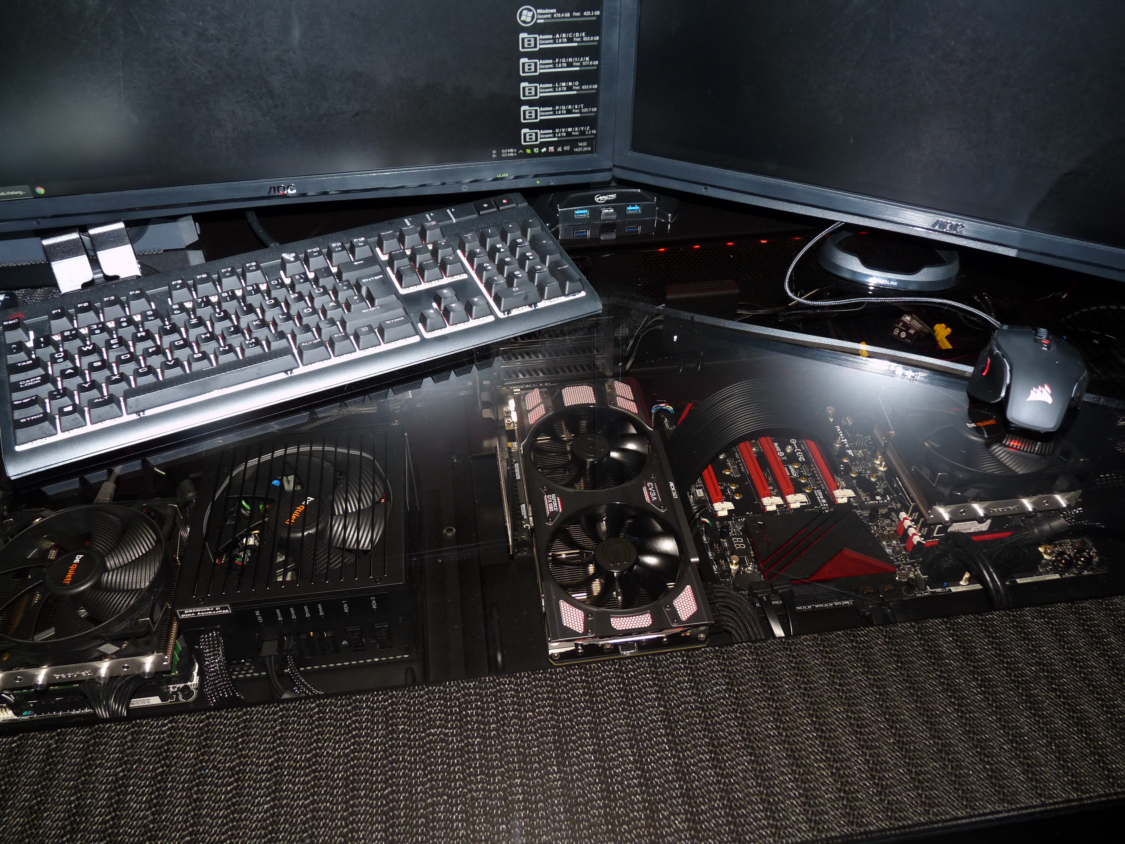

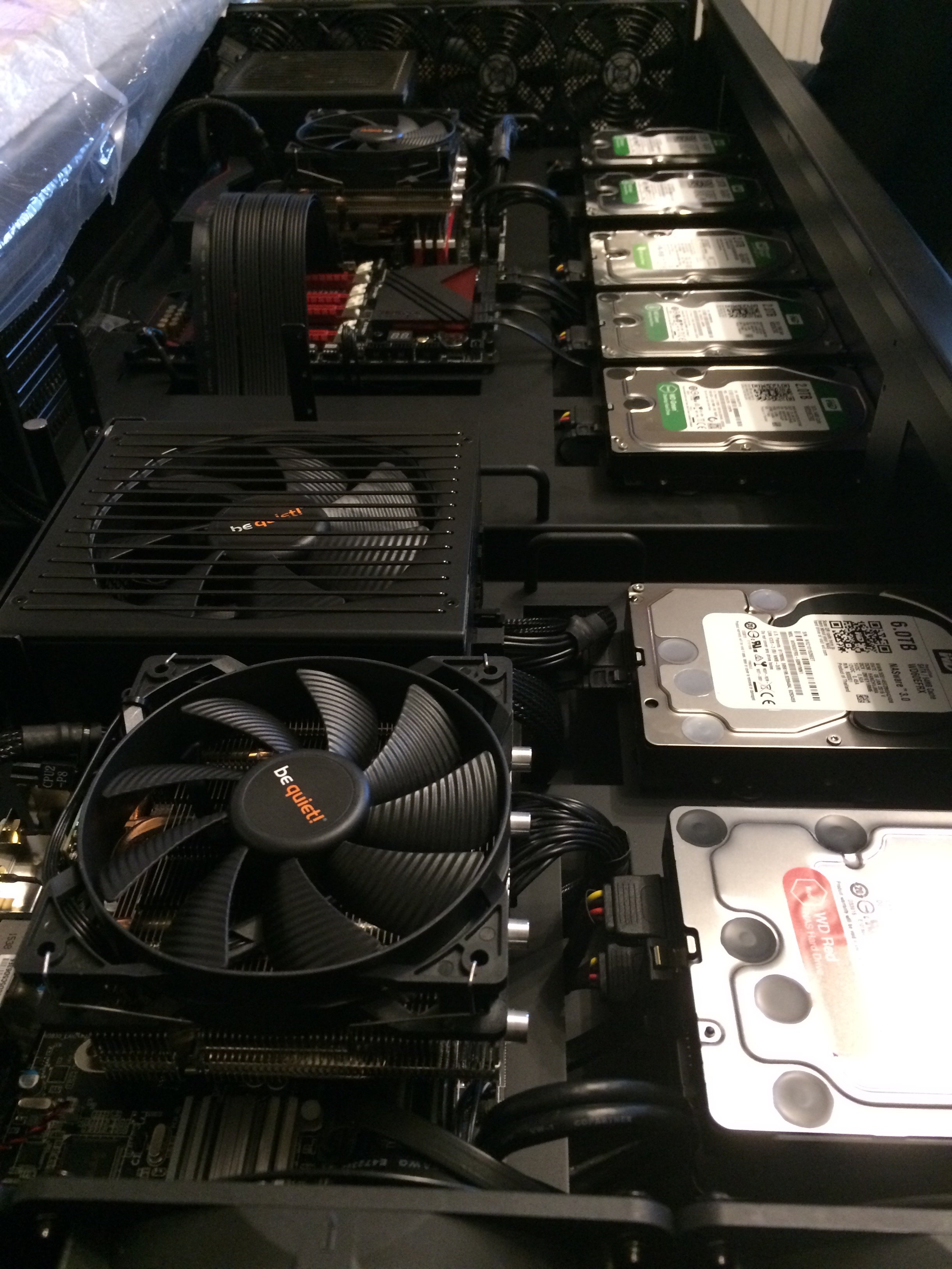

ill add a pictures of my pc desk solution so you can see why i had to use unraid for external media like games. all the internal drives i had for mass storage are full with files i need for work.
