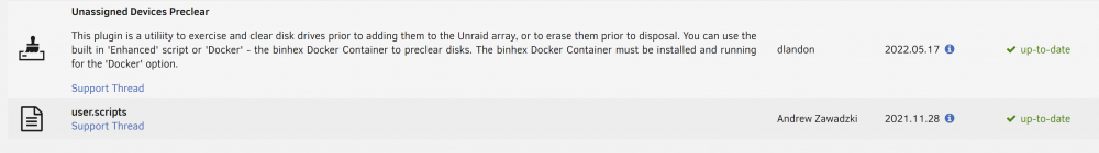

Same situation here but running 6.9.2.....

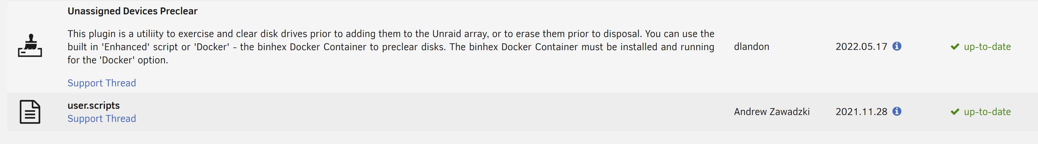

2 user.scripts set for BackgroundOnly and AfterArrayStart fail to run:
Checked using htop, filter for $ScriptName and user.script shows no running processes.
Scripts run perfectly using bash /path/to/ScriptName/script &
and show in htop.
Re-boot and perform tests, and confirmed that the scripts are not starting / running..
Only change to the system was update of Unassigned Devices Preclear ( to version 2022.07.10a ).
Nothing in system log to indicate failure to load user.scripts plugin...
Thanks in anticipation..

An update to UD Preclear is probably causing this problem.  Update UD Preclear and reboot.  All should be good again.
Hi @dlandon,
Indeed, updating with UD Preclear plugin to version 2022.07.11 ("Fix: Revert tmux to 3.1b for Unraid 6.10") fixed the issue with the User Scripts plugin on my system.
Many thanks (for this fix, and for your work in general on your plugins).

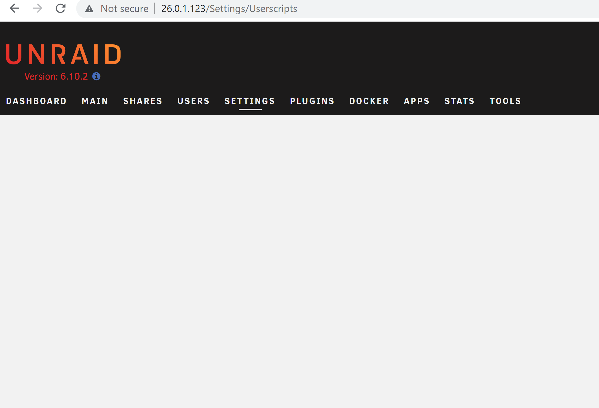

On 6/7/2022 at 8:05 PM, CBPXXIV said:
I'm having a weird issue.  I have strips installs, did it a while back and put some scripts in place.  Just went in to settings cause I wanted to check one of them and there is no icon for me to click, it's like it's not installed on my system.  If I click on it from the plugins page just goes to /Settings/Userscripts, but it's a blank page.  Thoughts?  Are my scripts even still running or are they gone?
Anyone??
22 hours ago, CBPXXIV said:
Anyone??
Check if you have "/boot/config/plugins/user.scripts". If so, your scripts should be in the "scripts" folder there, which you can back up and then re-install the plugin.
That did it, it actually repopulated the scripts by itself.  Thank you.

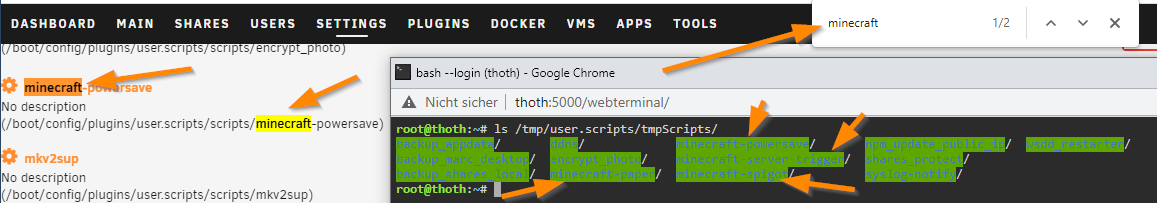

@Squid
Not really a problem, but it seems that scripts are not deleted from /tmp after they were removed through the GUI.

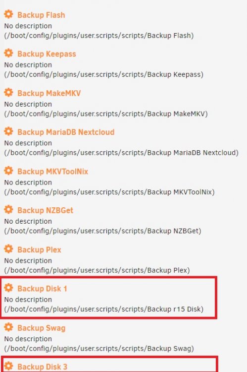

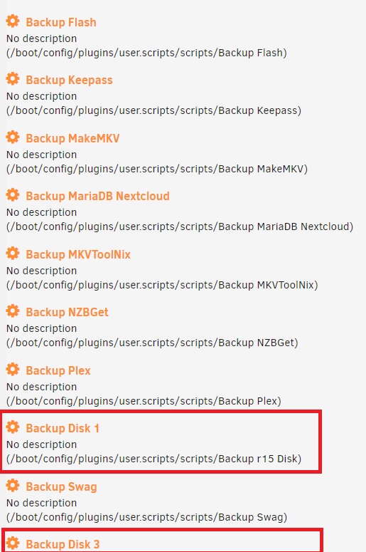

@Squid May I issue a Feature Request:
Is it possible to sort the User Scripts by it's title instead of it's filename? I'm running lots of User Scripts and I'm always searching for the requested User Scripts. The following screenshot shows part (!!!) of my User Scripts. I hope you can see the "annoyance". No rant here - in fact I love and use your script heavily. When using lot's of User Scripts there is high chance that you rename the title over time and this is not reflected in the list.
Thanks for listening.
@Squid I just submit a change to the code to get this functionality in if you want to look it over
