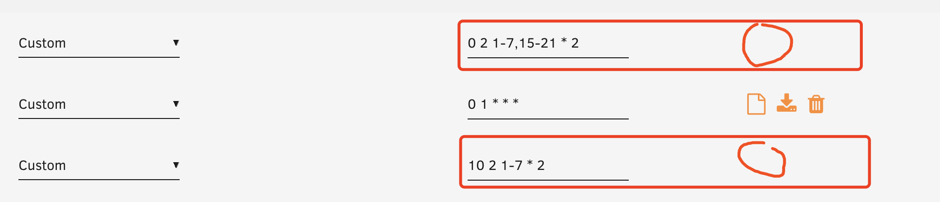

I have some trouble with cron: shouldn't it be executed on September 6th?
Instead of using ranges, try 1,2,3,4,5,6,7,15,16,17,18,19,20,21
