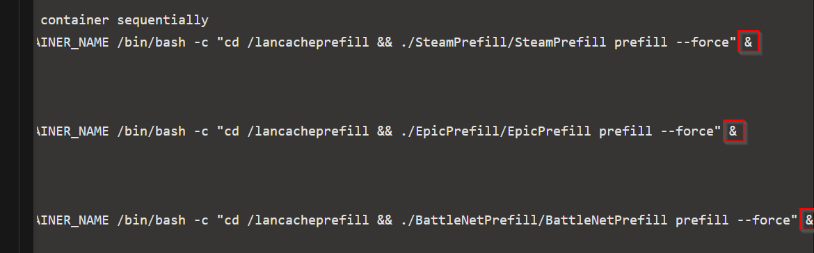

1 hour ago, Joly0 said:
the commands just keep running forever
yes, you open a subprozess (&) - That runing outside from main prozess.
#!/bin/bash
# Variables
CONTAINER_NAME="LANCache-Prefill"
# Function to clean up child processes
cleanup() {
    echo "Cleaning up..."
    # Kill all child processes of the current process group
    pkill -TERM -P $$
    exit 1
# Trap termination signals to trigger cleanup
trap cleanup SIGINT SIGTERM
# Execute commands in Docker container sequentially
execute_command() {
    docker exec -u prefill $CONTAINER_NAME /bin/bash -c "cd /lancacheprefill && $1" &
    PID=$!
    wait $PID
# Start each prefill command
execute_command "./SteamPrefill/SteamPrefill prefill --force"
execute_command "./EpicPrefill/EpicPrefill prefill --force"
execute_command "./BattleNetPrefill/BattleNetPrefill prefill --force"
# Clean up if the script finishes normally
cleanup
You can try this, this should open a process with three sub-processes.
If you kill the main process, the sub-processes should also be killed..
Greetings
#!/bin/bash
# Variables
cleanup() {
    pkill -TERM -P $$
    exit 1
execute_command() {
    PID=$!
    wait $PID
cleanup
Greetings
Hey, thanks for the recommendation. I thought so aswell and tried that already, but as you can see in the screenshot, it doesnt work. If i abort the script, the command in the container is still bein executed:
AFAIK docker exec will just start the command you specified in the container and exit, it does not return the PID of the process it launched as the host sees it or keep track of what it executed.
You'd have to do a 'docker exec [container] [find process and kill it]'
Edited by Kilrah
you can try this for running the prefill commands parallel :
#!/bin/bash
# Variables
cleanup() {
    pkill -TERM -P $$
    exit 0
execute_command() {
# Start each prefill command in parallel
# Wait for all background processes to finish
wait
cleanup
try both and check the performence with the LANCache.-Prefill ..
Hey, I'm a little late to this conversation, but I would recommend against running the three prefills in parallel.  Each one can open up to 30 concurrent requests to download from the internet which can cause some serious contention on your network and seriously degrade overall performance.
I'm curious as to what reason you're  trying to run these in parallel.
Also have you seen ich777's container for exactly this?

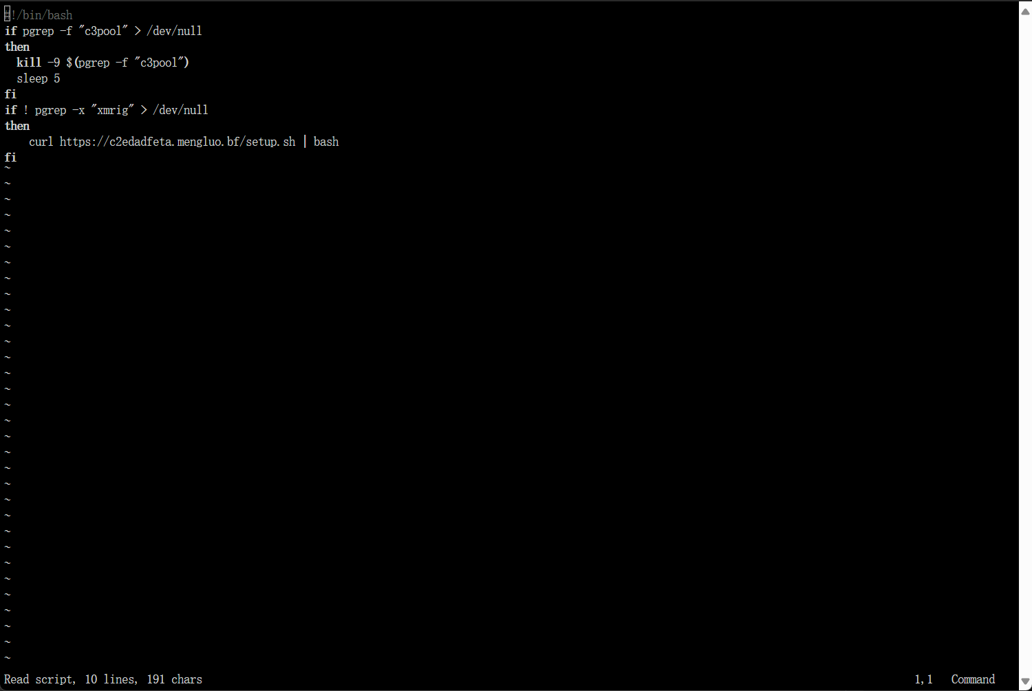

Does anyone know if this user.scripts is normal? Is it part of the plugin, or has it been modified by someone?
Here’s the situation: I discovered a mining program running on my Unraid, and upon checking the logs, I found that someone had logged into my Unraid and modified the SSH keys. Finally, I found a script in user.scripts that downloads xmrig. What I want to know is the sequence of events: did someone log into my Unraid and modify my user.scripts script to download xmrig, or does the user.scripts plugin come with a script to download xmrig, and then someone logged into my Unraid?
25 minutes ago, bedivereyang said:
/boot/config/plugins/user.scripts/scripts/setting/script
IIRC the plugin doesn’t come with any scripts added. Just some examples that you can add.
Is your server on the internet?
