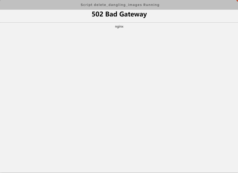

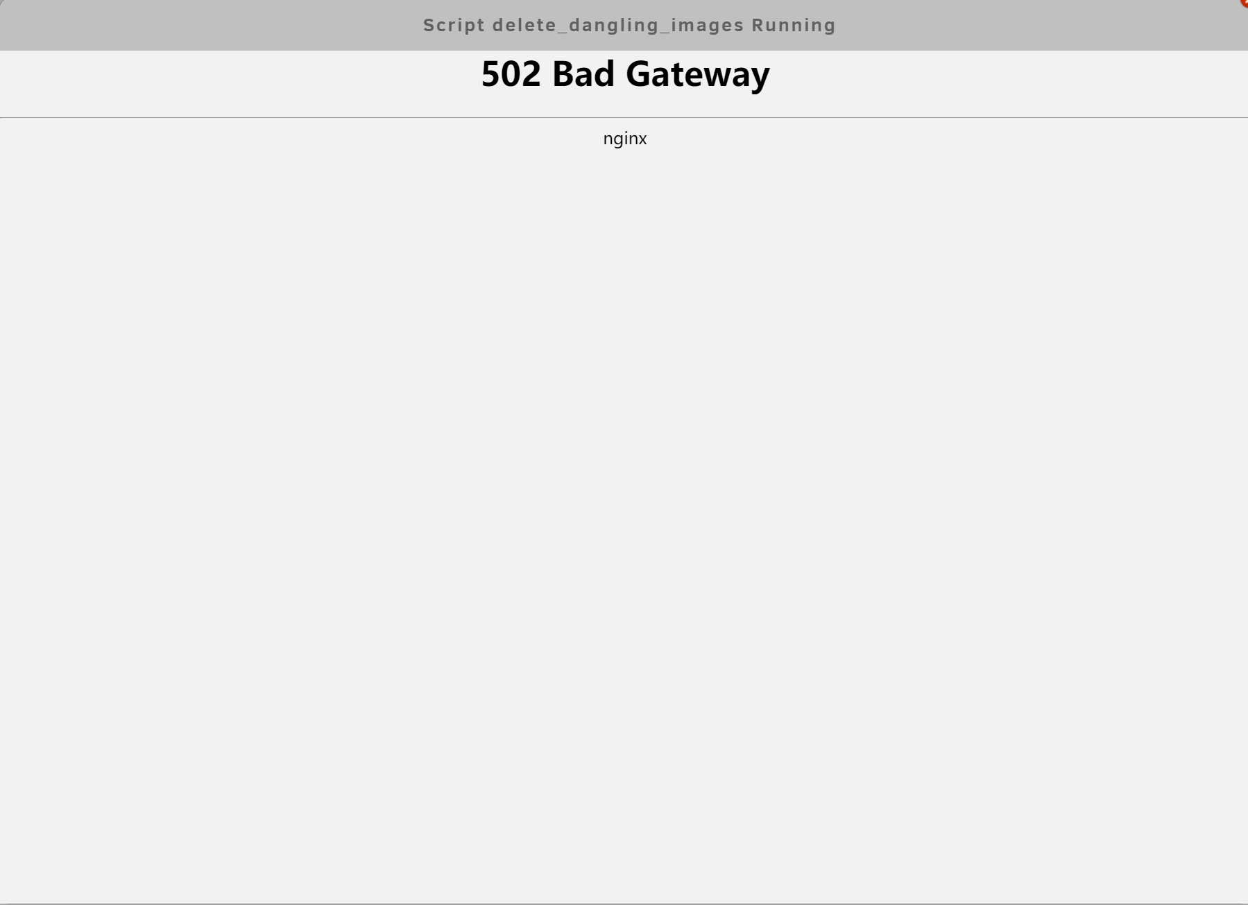

On 3/15/2023 at 8:56 AM, dayvight said:
I have a problem about 502 bad gateway when i run script or run in backgroud.I tried to reinstall the plugin to no avail.
Heya, did you ever find a solution for this? I'm currently experiencing the same issue but I couldn't see a reply by anyone to your post?
Thanks :)
