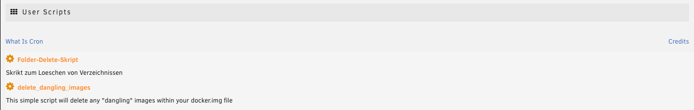

Probably since the update to V7 I have been missing the buttons to start the scripts and check the log files. Only the list on the left with the scripts is still there
Fixed ... do not use very long descriptions or seperate lines with <br> ....
Edited by Ralf Hammeran
