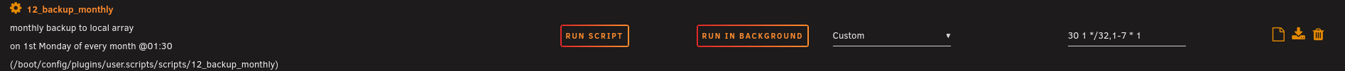

Is there a difference between normal crontab jobs and how User Scripts is scheduling jobs?
I have a script that I want to run on every first Monday of each month. I have setup User Scripts to use a custom schedule with the following syntax:
30 1 */32,1-7 * 1
which according to https://crontab.guru/#30_1_*/32,1-7_*_1 should do exactly what I need. However Unraid seems to run this script on every Monday instead:
My configs seem to be correct though:

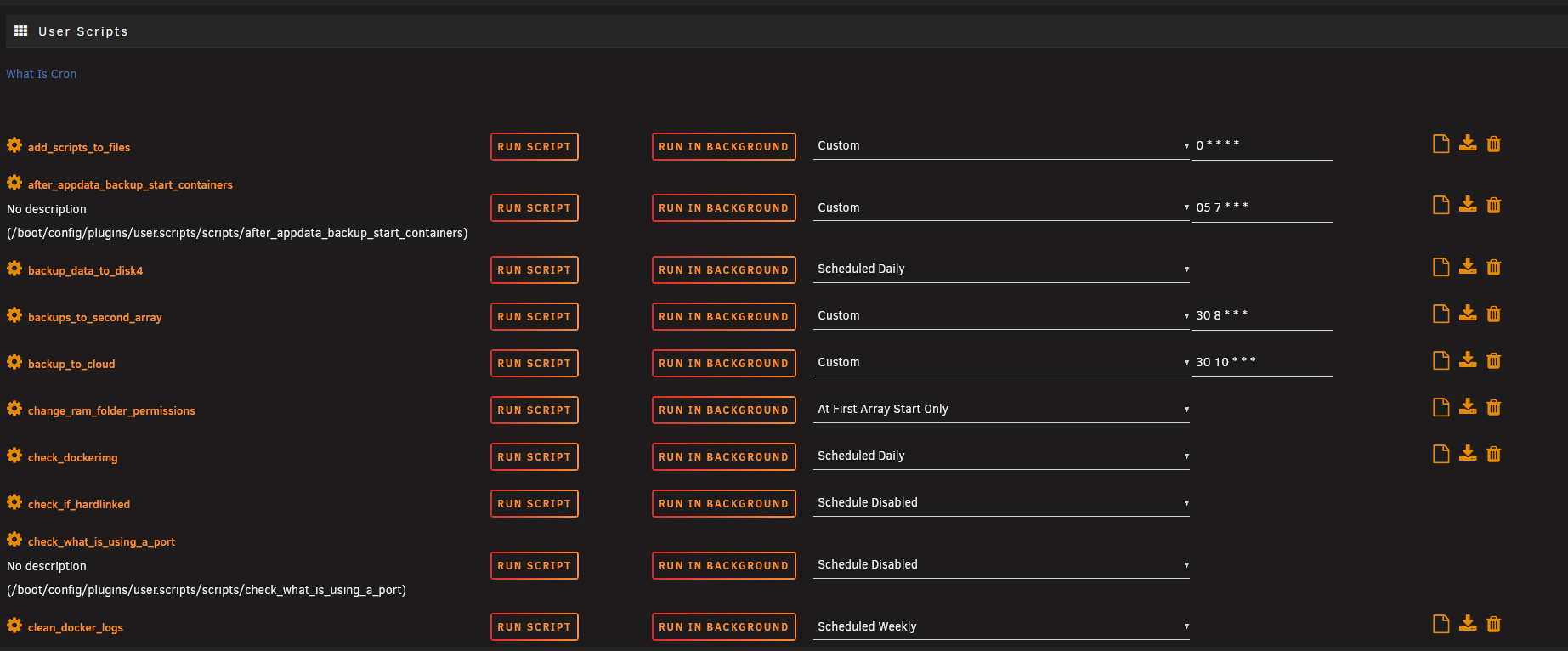

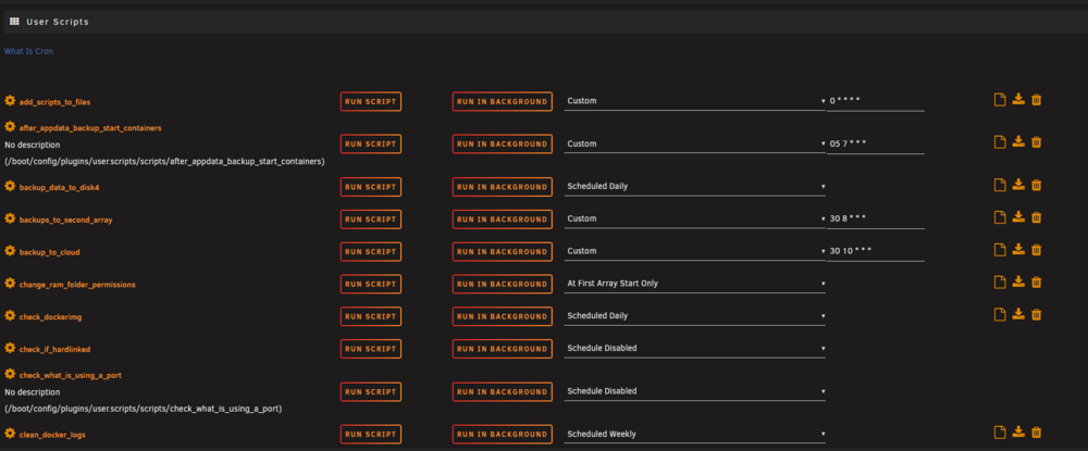

I wanted to ask, if you also noticed that the plugin has a visual issue when updating unRAID to 7.2.0 beta. Unlike previous unRAID versions, there's no space between the last two elements.
It's not a big deal, but it looks ugly (especially because the lines are not at the same height).
until 7.2.0 beta
With 7.2.0 beta
Edited by petbrau
7.2 userscripts has some formatting issues, schedule field is to close to the custom schedule fieldimage.png
