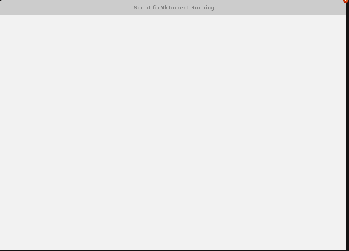

Hi all,
in Unraid 7.2 i cannot see anymore the "log" of the script until this is completed.
It will just show an empty blank page without the status of the script.image.png

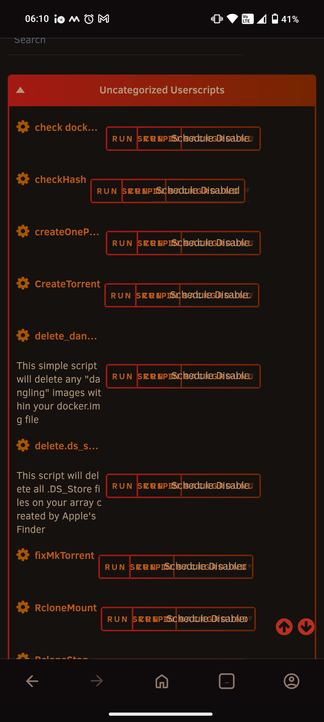

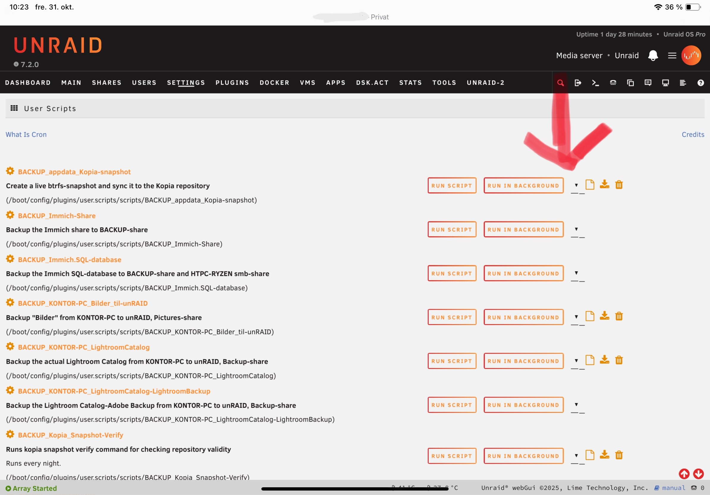

First of all; many thanks for this great plugin!
It seems that there also is a new bug on unRAID 7.2 where the "schedule" field gets truncated and not visible anymore. This happens when I view the plugin/User scripts from my iPad Pro 11inch and also my iPhone 14 Plus.
Actually, when opening the user scripts page through a mobile device it looks normal in about 1 second before the schedule-field gets truncated.
When viewed on a PC everything looks normal.
In Unraid Display Settings I use the boxed view. Not sure if that affects this or not.
See this sceenshot from my iPad:
Edited by menkromsen
You should install user scripts enhanced, Much better UI, and looks to be responsive
User scripts enhanced is not usable in mobile
On 10/31/2025 at 2:35 AM, Yusseiin said:
Hi all,
I
Im still on 7.1.2 and same happens here...

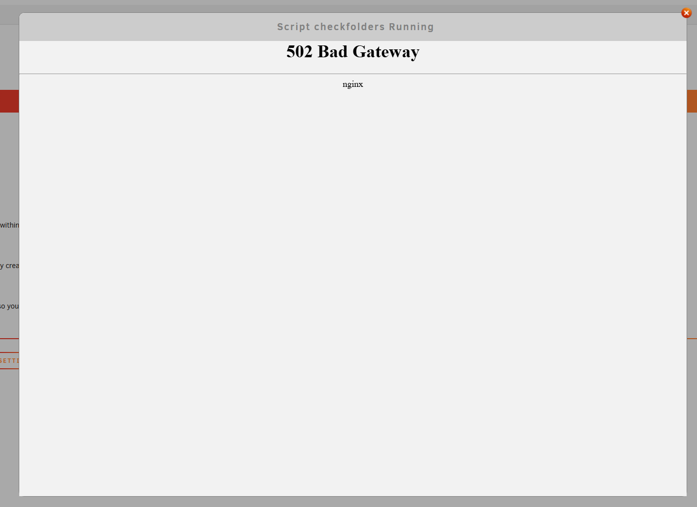

For me it was working on 7.1.*. Are you using an AdBlocker or Brave? It was not working on Brave.
works fine by direct ip.
Doesn't work when I use a fqdn locally with swag reverse proxy, ie (unraid.fqdn.com)
I can confirm that. Direct access via the IP works, but I don't get any log output when accessing it through my Reverse Proxy. I do not have an ad blocker active. The log download also works via the Reverse Proxy.
Edited by tasch
Also getting a 502 Bad Gateway
Connecting via direct IP
