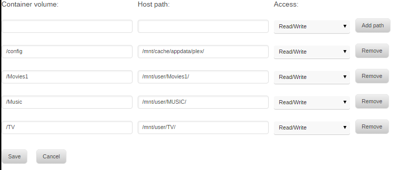

docker or plug-in. I am assuming docker since this is a common error for first time users. For Plex (inside the docker) to see shares on the server they need to be exposed using volume mapping. See pic for example mappings. Once set, the names you assigned in the left-hand column will appear in Plex to use as root for a Library. Then it will work. :)

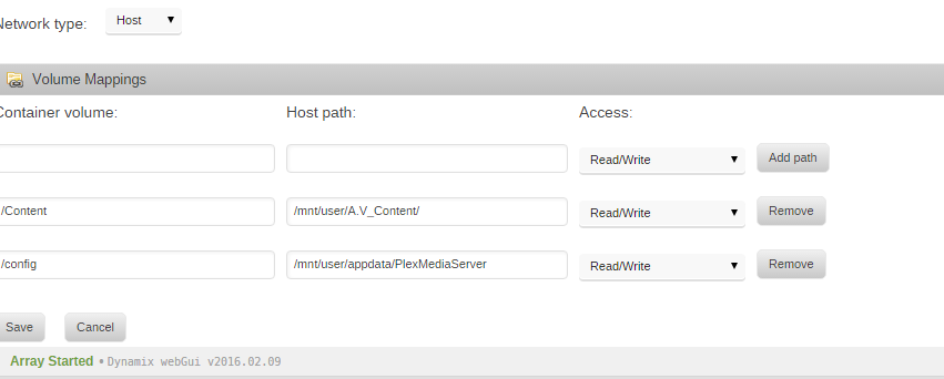

Evening, please see screen shot attached of docker volume mapping, plus running 6.1.8
found folders under Plex ... under /content.... I couldn't have have done without your help.. appreciated!
in Plex the share should appear at the top level of the list. Don't drill into /mnt/
